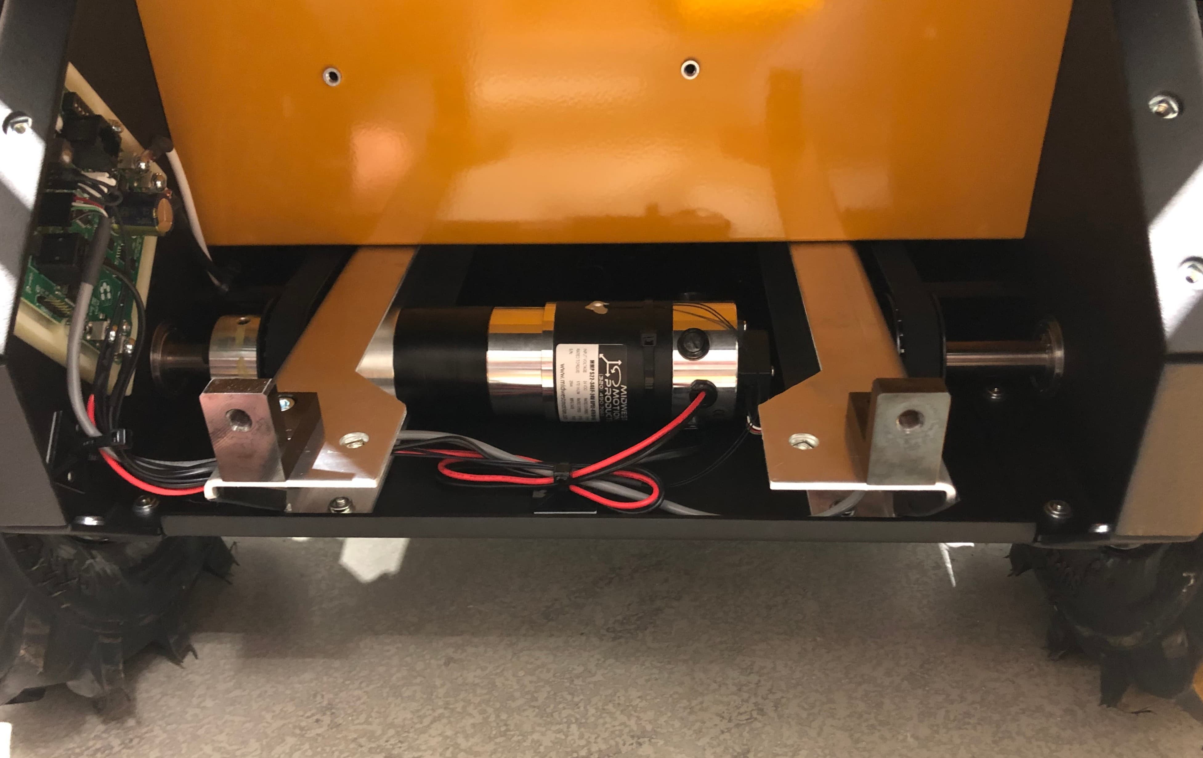

Noise from inside the Husky inner compartment
Please remove the front cover of the Husky.

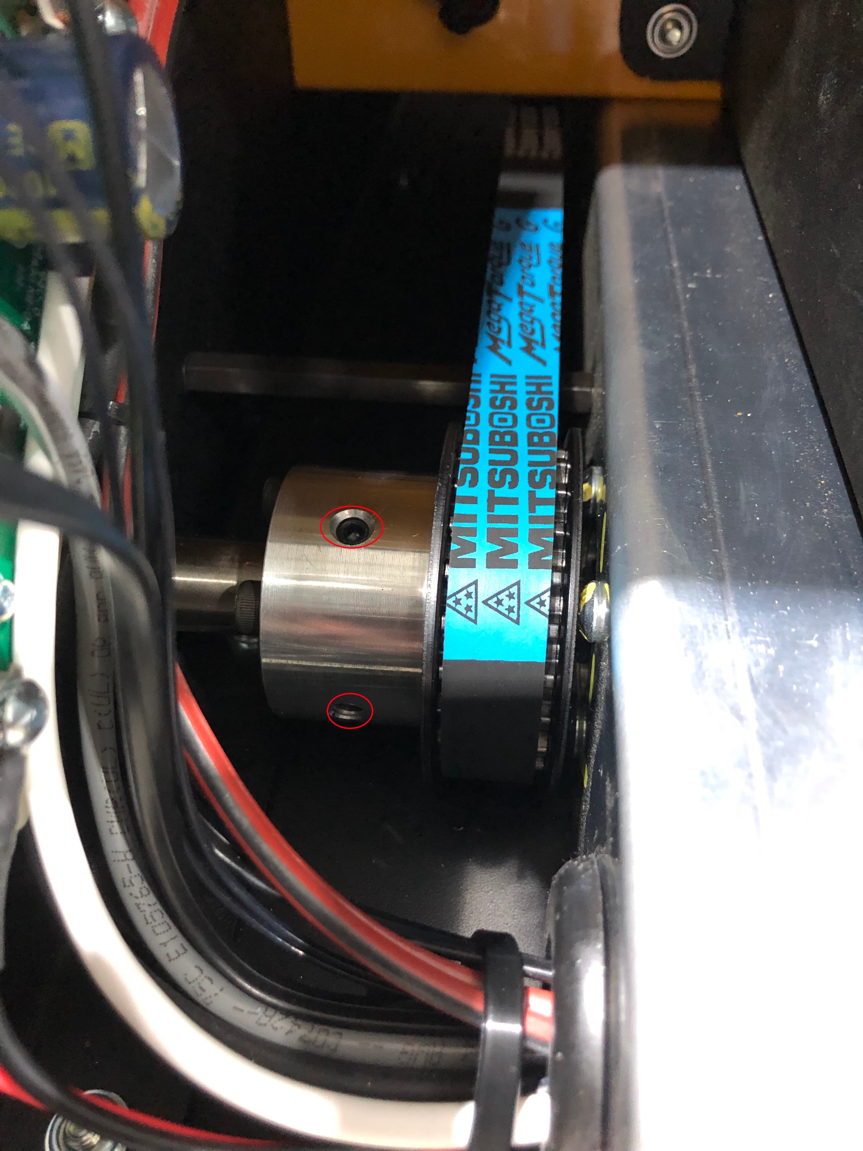

Tighten the marked grub screws.

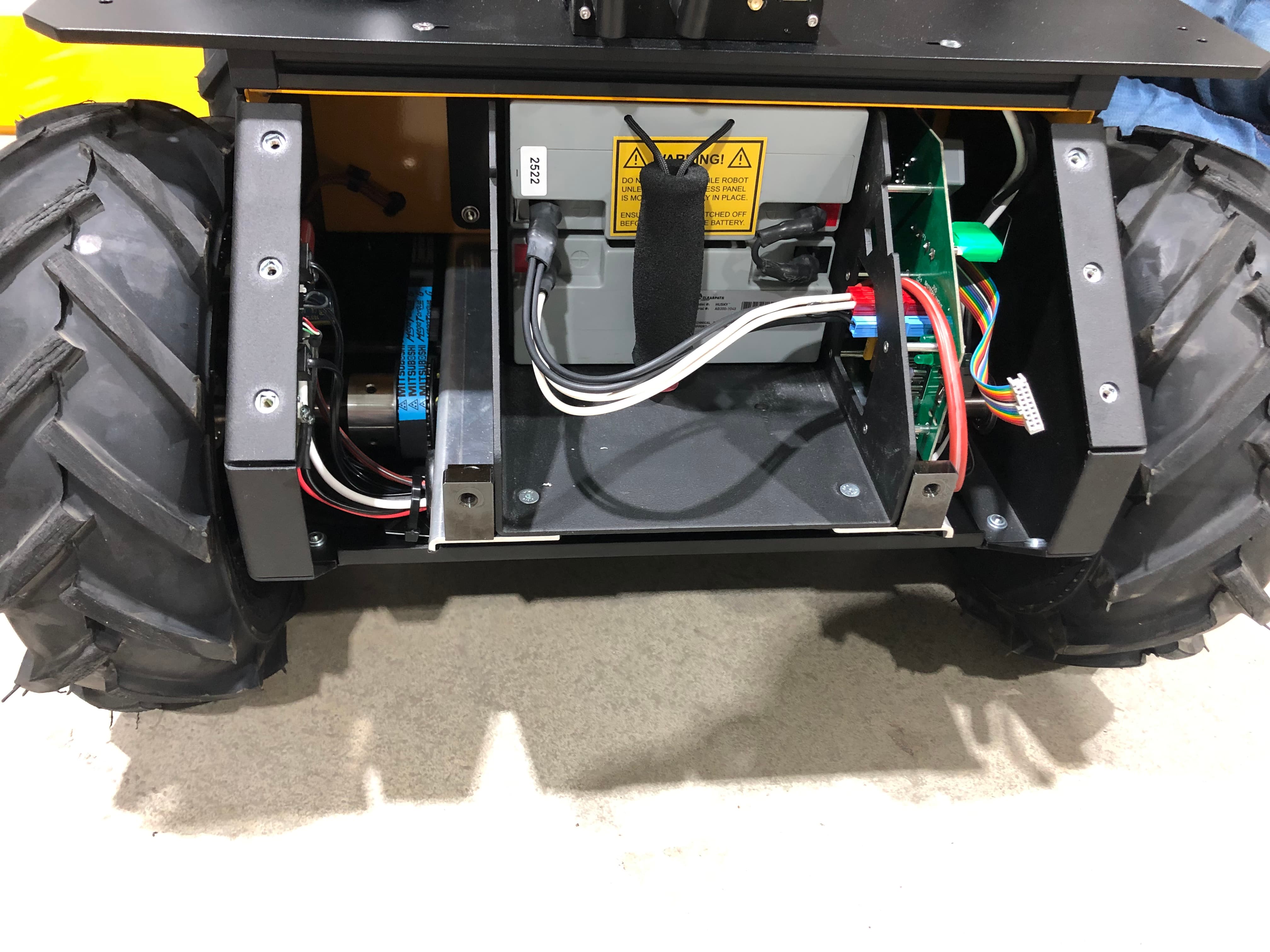

Please remove the back cover of the Husky.

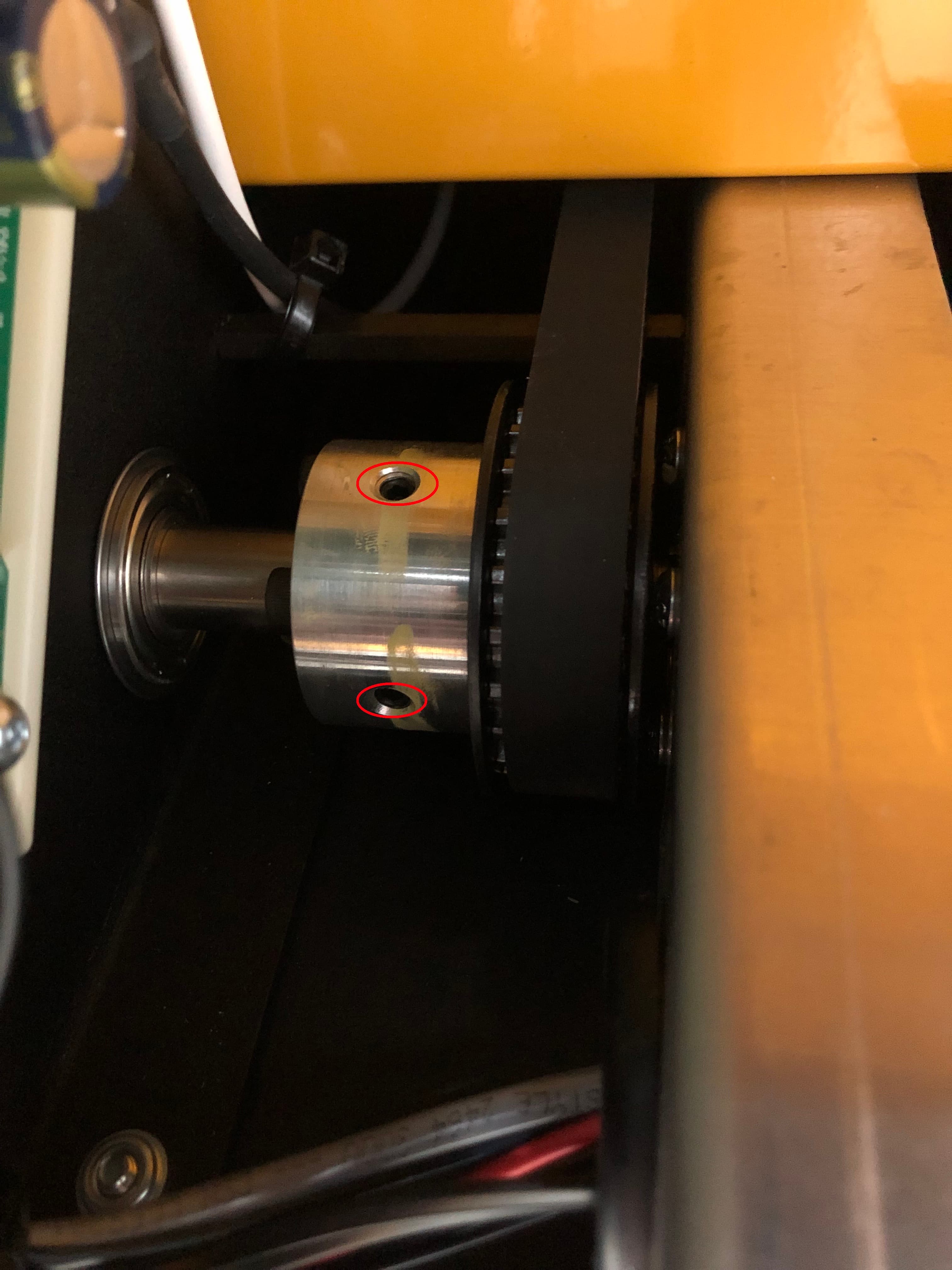

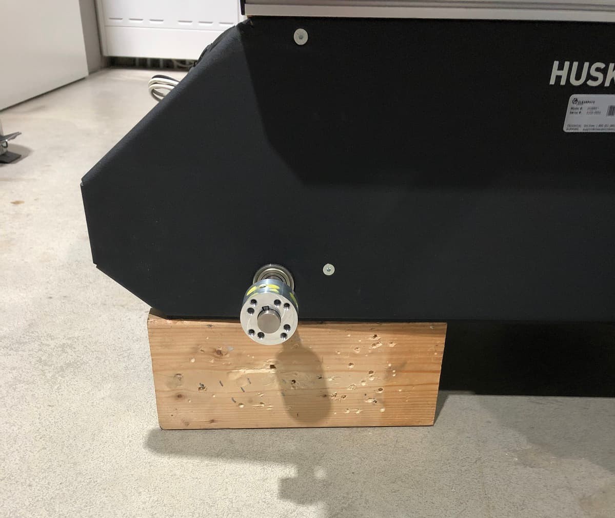

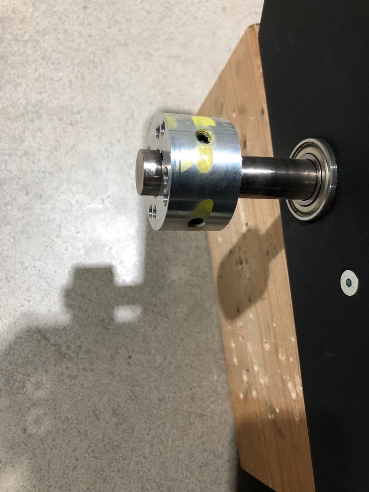

Additionally, you may have to tighten the Husky wheels grub screws.
