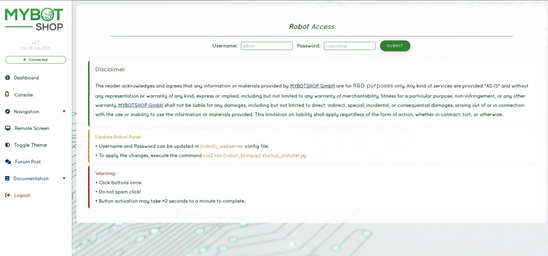

Default Credentials:
  • Username: admin
  • Password: mybotshop
Login
_images/web_login.webp
Webserver Login

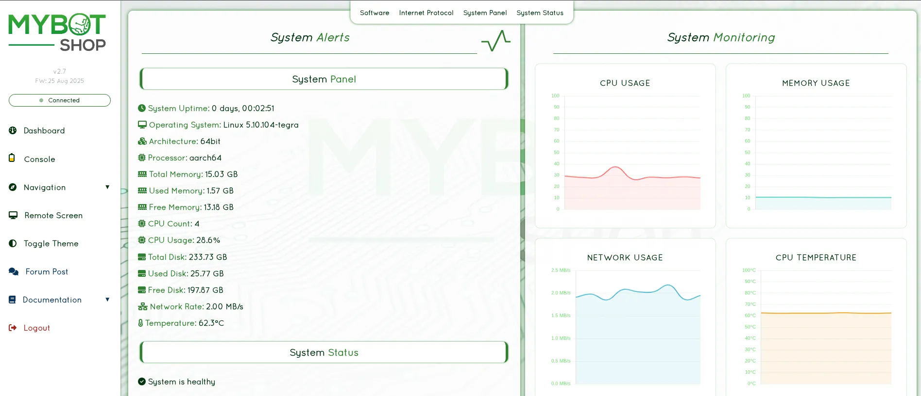

Dashboard
_images/web_dashboard.webp
Webserver Dashboard
The dashboard provides:
  • View IP Address of the Husky A300
  • View system load and status

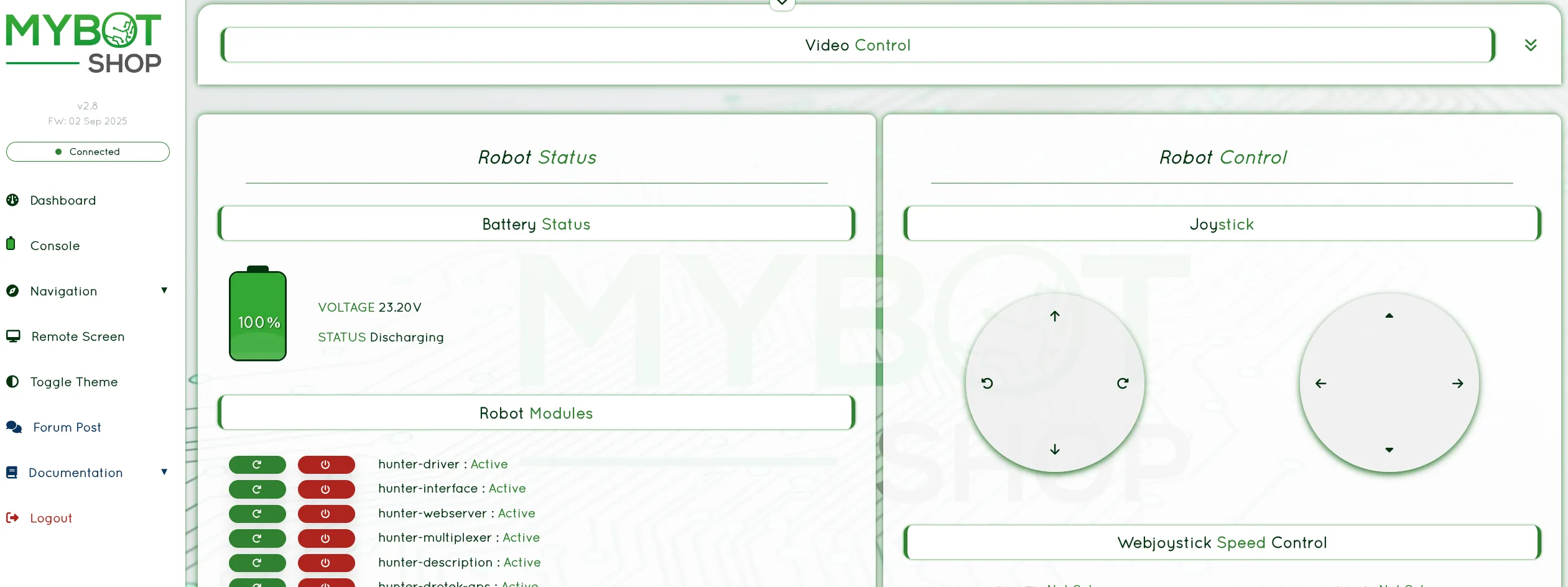

Console
_images/web_console.webp
Webserver Console
From the Console you can:
  • Enable/Disable Husky A300 ROS 2 services
  • Record system logs
  • Monitor battery status
  • Use pre-configured action buttons
  • Use the web joystick
  • View online image streams

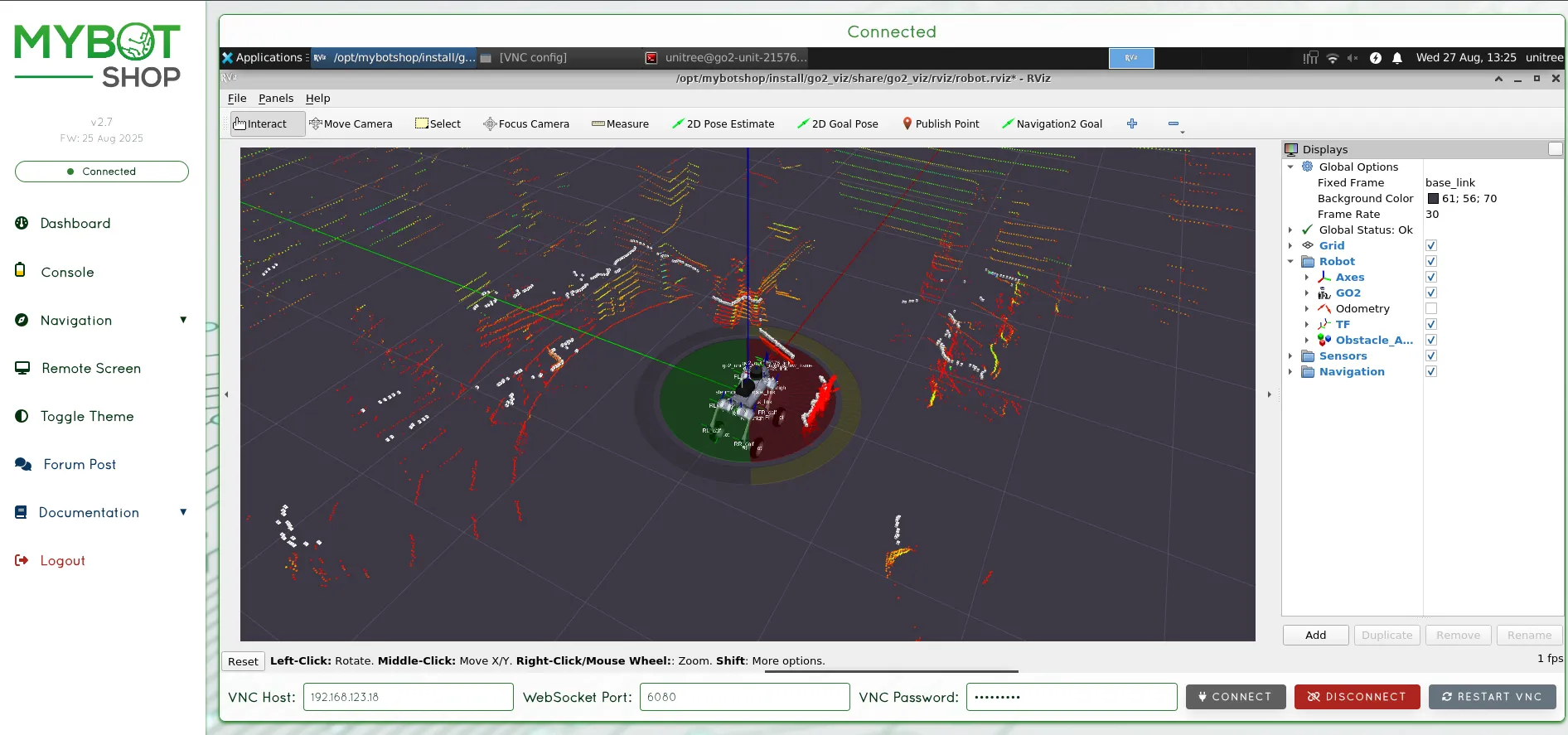

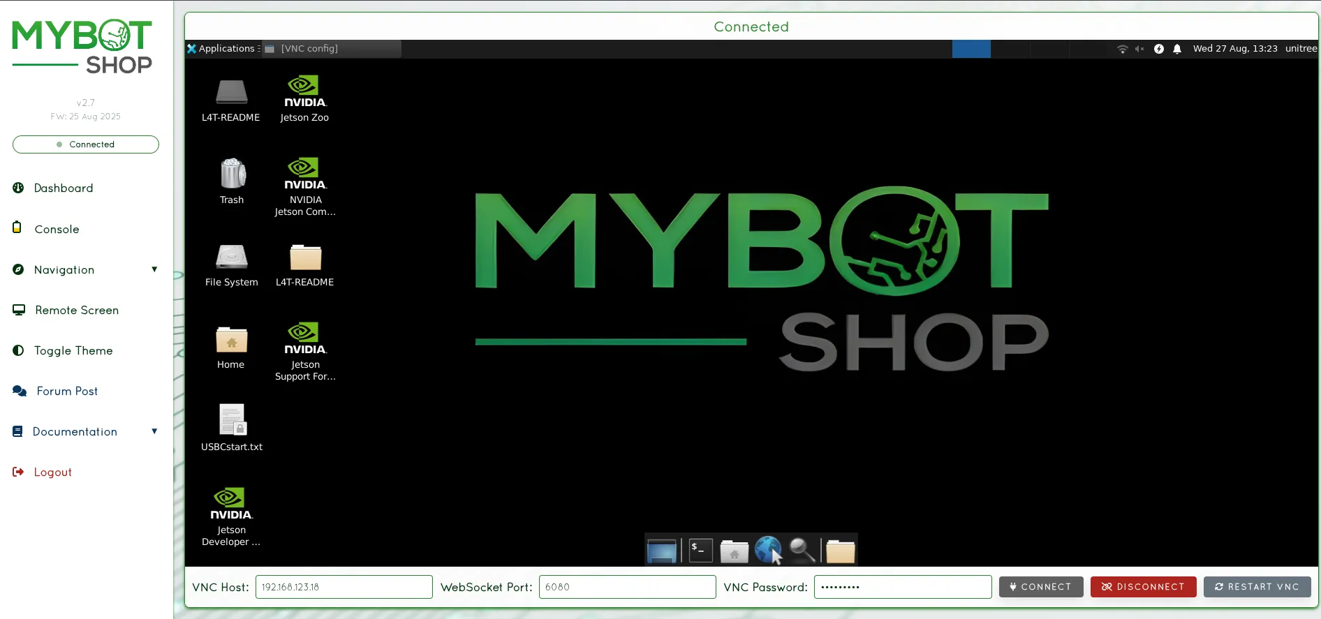

Remote Desktop
_images/web_vnc.webp
Husky A300 Remote Desktop (VNC)
Provides access to the on-board screen of the Husky A300’s computer.

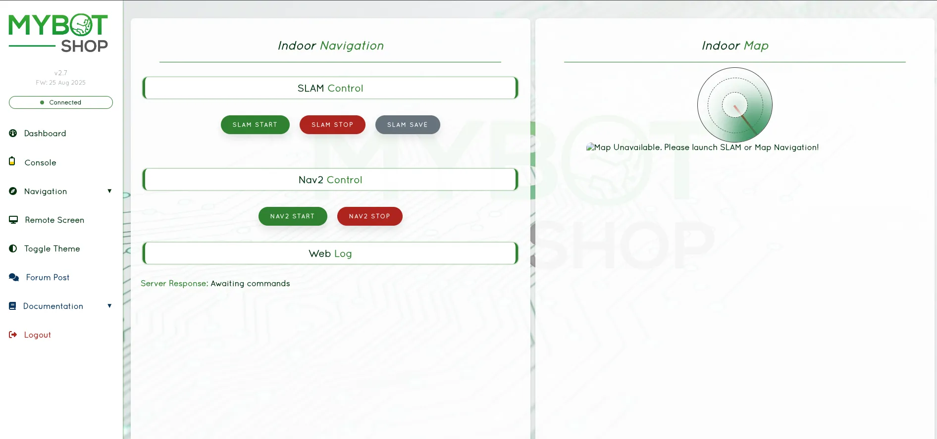

Indoor Navigation
_images/web_nav_indoor.webp
Indoor Navigation Interface

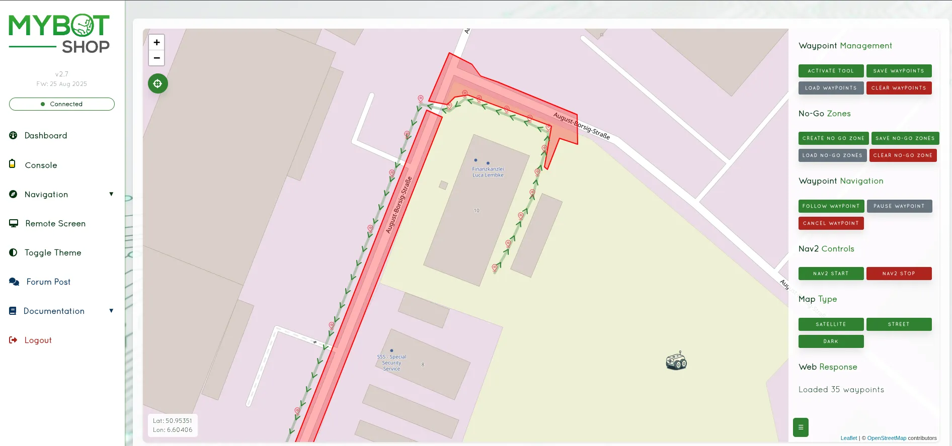

Outdoor Navigation
_images/web_nav_outdoor.webp
Outdoor Navigation Interface
