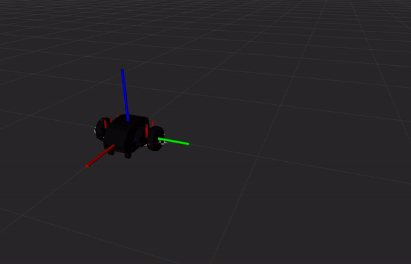

Diablo Viz
This ros package is used for visualization of the robots current state both in simulation and in the real-hardware.
ros2 launch dingo_viz view_robot.launch
