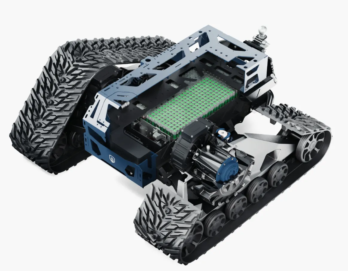

The MYBOTSHOP ROVO2 is a rugged tracked robot platform designed for autonomous mobile robot (AMR) applications. The tracked chassis provides superior terrain traversal capabilities compared to wheeled platforms, making it ideal for outdoor environments, rough terrain, and challenging surfaces.
The power pack is driven by 2 x 7.5KW electric motors, reduced via 1:16 gears providing considerable payload and tractive force. Despite the high gear reduction, the MBS ROVO2 reaches a top speed of 20km/h. The battery integrated in the chassis provides an extremely low center of gravity and a range of approximately 8 hours or 40km.

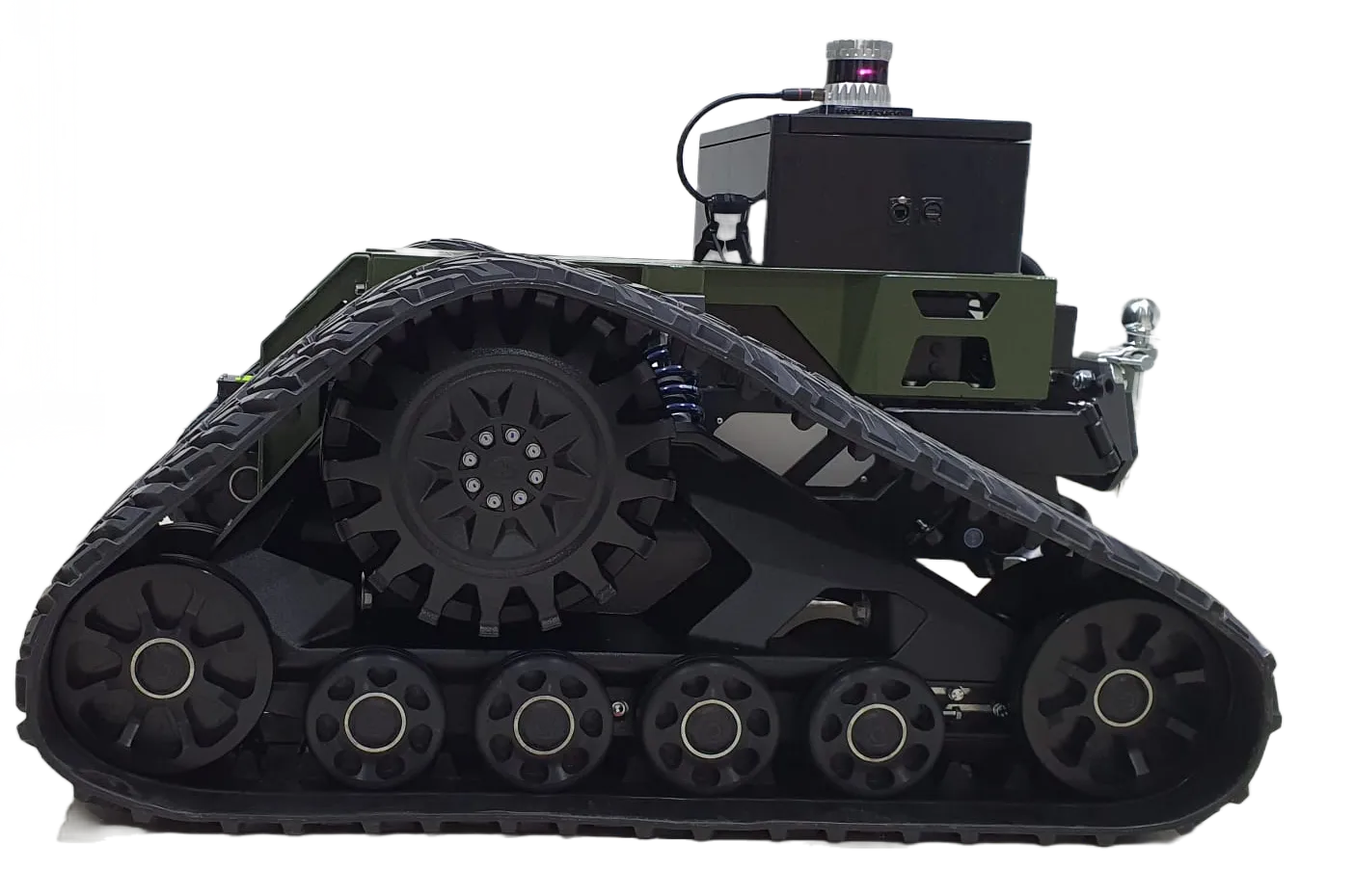

ROVO Platform
The ROVO2 is based on the HAWE Mattro ROVO platform, a fully electric tracked drive system designed for off-highway autonomous applications.

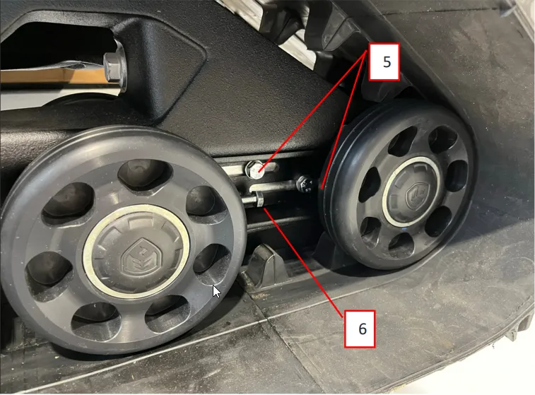

Belt Tightening
In case the ROVO veers off to either the left or right, the issue may be traced back to the tracks being loose.
ROVO2 Belt Tightening Adjustment
To remedy this situation:
First loosen screw number 5
Adjust the track tension with screw number 6
Finally, tighten screw number 5 again with
25Nm
