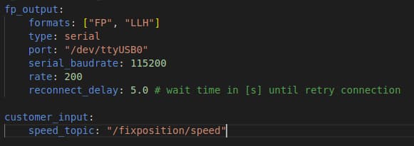

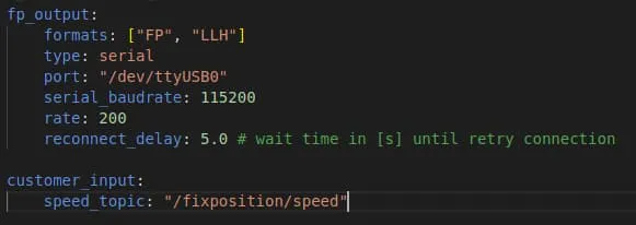

Fixposition Serial
Configure the connection port:
roscd fixposition_driver/launch/
gedit serial.yaml
Ensure that the port in the
yaml fileof the Fixposition corresponds correctly to where it is connected.
To launch the node in serial mode, run:
roslaunch fixposition_driver serial.launch

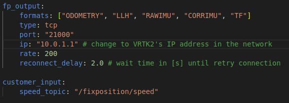

Fixposition WiFi

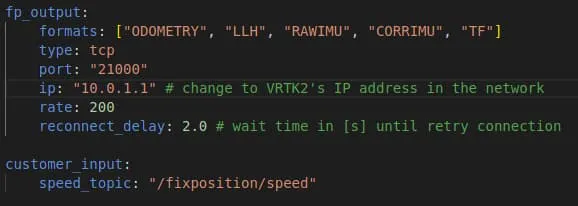

gedit tcp.yaml
Ensure that the ip in the
yaml fileof the Fixposition is10.0.1.1. Extra information can be acquired via the formats. For more information on the output data from the Fixposition receiver, please refer to the manual or the Github.
To launch the node in tcp mode WiFi, run:
roslaunch fixposition_driver tcp.launch

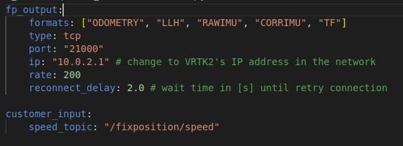

Fixposition LAN (Recommended)
gedit tcp.yaml
yaml fileof the Fixposition is10.0.2.1. Extra information can be acquired via the formats. For more information on the output data from the Fixposition receiver, please refer to the manual or the Github.
To launch the node in tcp mode LAN, run:
