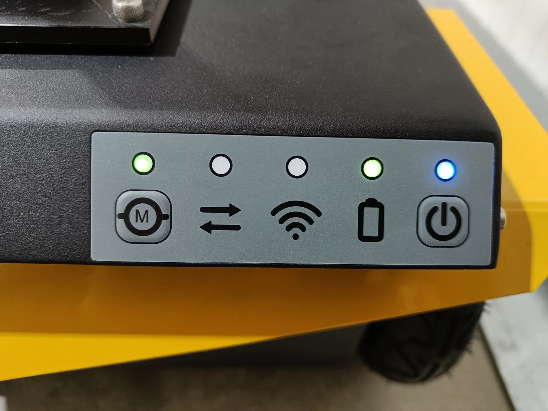

The Jackal is activated by pressing the designated power button. When initiating startup alongside the Ouster and Zed2i, it may require up to a minute to commence fully.
_images/jackal_power.webp
  • The illuminated green light on the `M` signifies the successful initiation of the MCU, while the directional arrows indicate its readiness to receive commands from the onboard PC.
  • This particular Jackal model is equipped with an Ouster LiDAR and Stereolab ZED2i camera. Instances, where the LiDAR or other supplementary components are integrated into the robot’s startup procedure but encounter cable disconnection or damage, may result in startup failure.

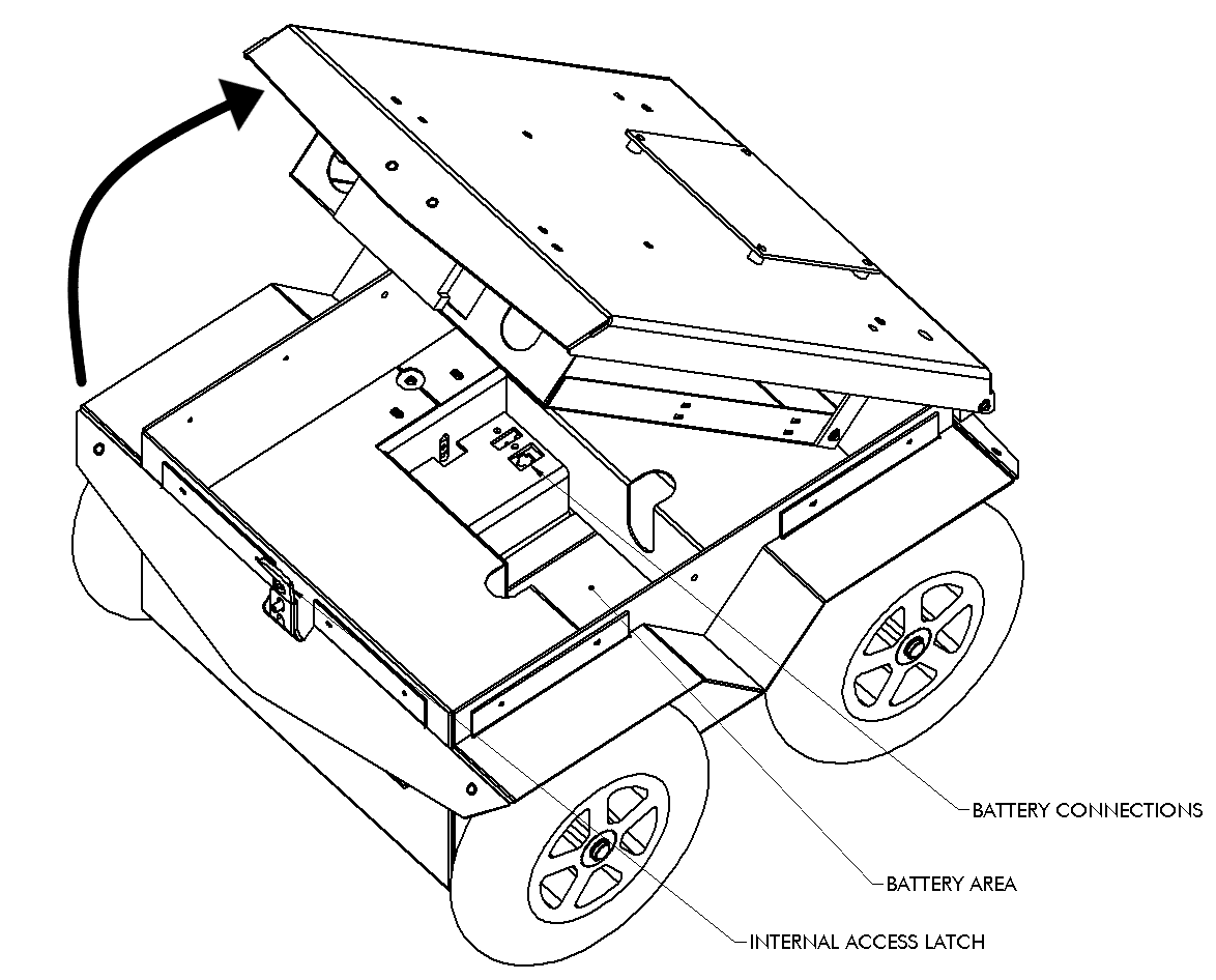

Accessing the Battery
To access the battery, release the latches under the front end of Jackal’s lid, opposite the HMI. Once the lid is lifted, you will see Jackal’s onboard lithium battery and its two connectors:

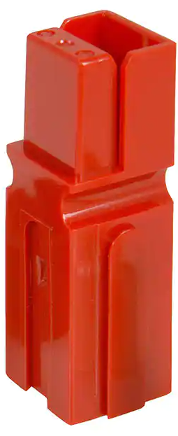

  • Anderson Power Pole Connector: Supplies power to Jackal and must be connected for operation.

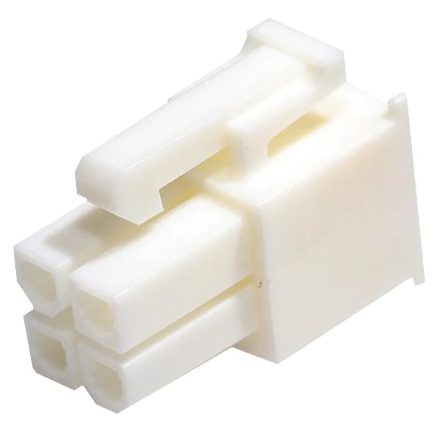

  • Molex Connector: Allows the battery to be charged internally while Jackal is powered off.
_images/anderson_powerpole.webp
_images/molex_mini.webp
Molex Connector
