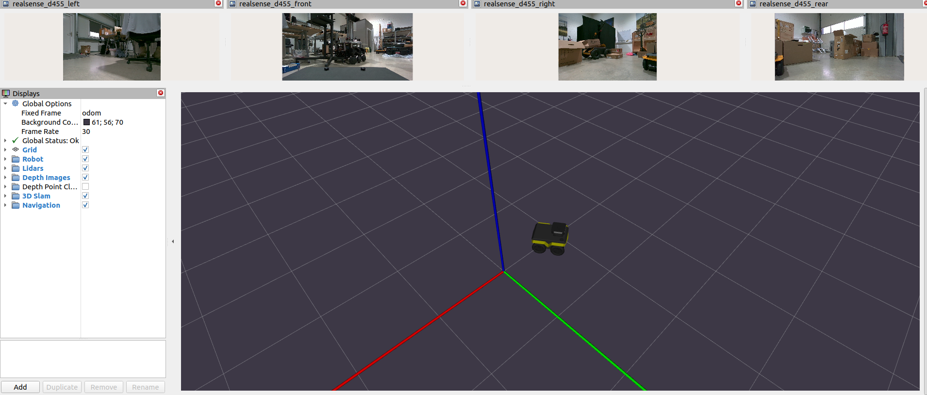

Digital Twin (RVIZ2)
To visualize the Jackal, you can run:
ros2 launch jkl_viz view_robot.launch

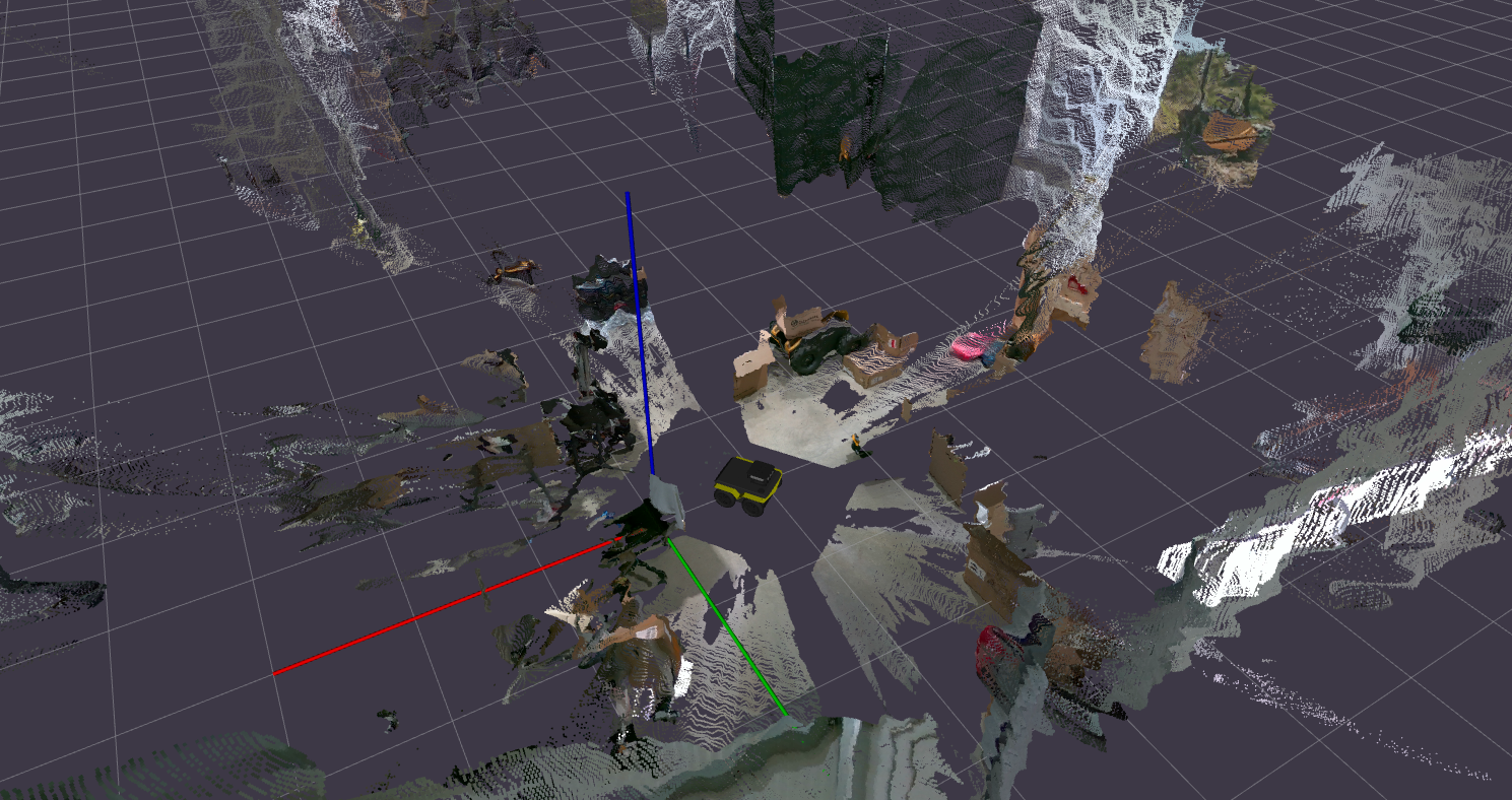

_images/jkl_dpcd.webp
Jackal Depth Point Clouds
