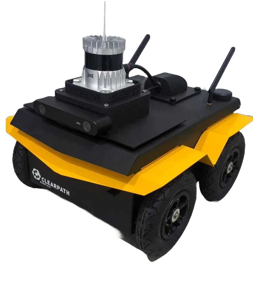

Platform Overview
Jackal is a durable, lightweight, and fast unmanned ground robot designed for rapid prototyping and research purposes. It comes equipped with an onboard computer, as well as essential IMU and GPS capabilities. Standard perception tools are available, featuring URDF, simulator integration, and demonstration applications.

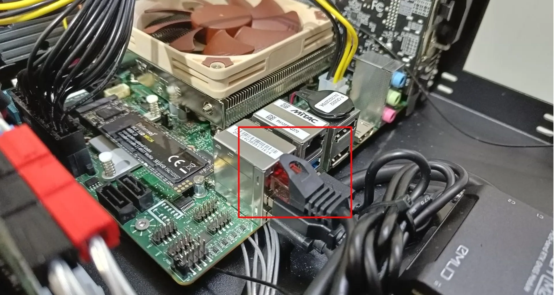

  3. Connect ethernet cable
The Ethernet port at the back of the Jackal can be utilized for setting up communication via LAN.

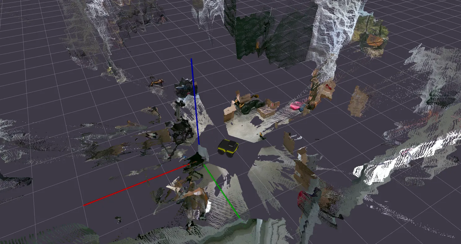

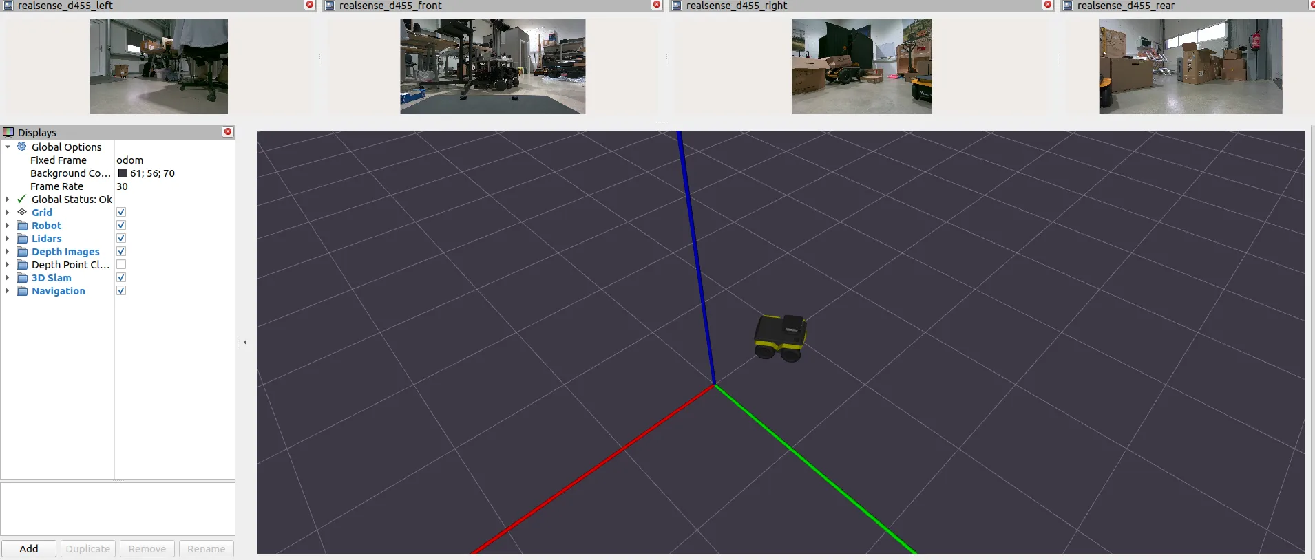

Digital Twin (RVIZ2)
To visualize the Jackal, you can run:
ros2 launch jkl_viz view_robot.launch.py
_images/jkl_dpcd.webp
Jackal Depth Point Clouds
_images/jkl_dimg.webp
Jackal Depth Images
