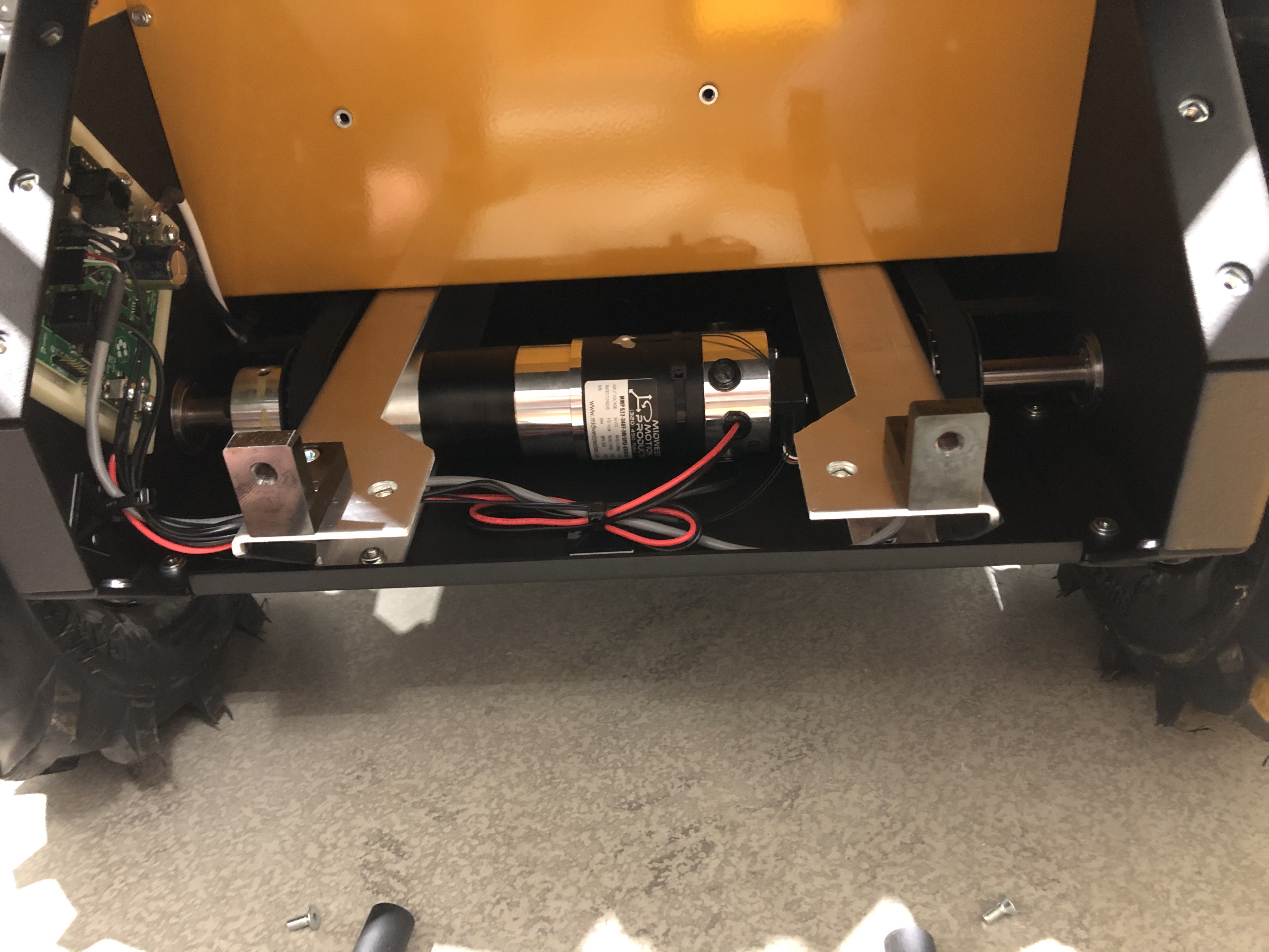

Noise from inside the Husky inner compartment
  • Please remove the front cover of the Husky.
_images/IMG_7443.webp

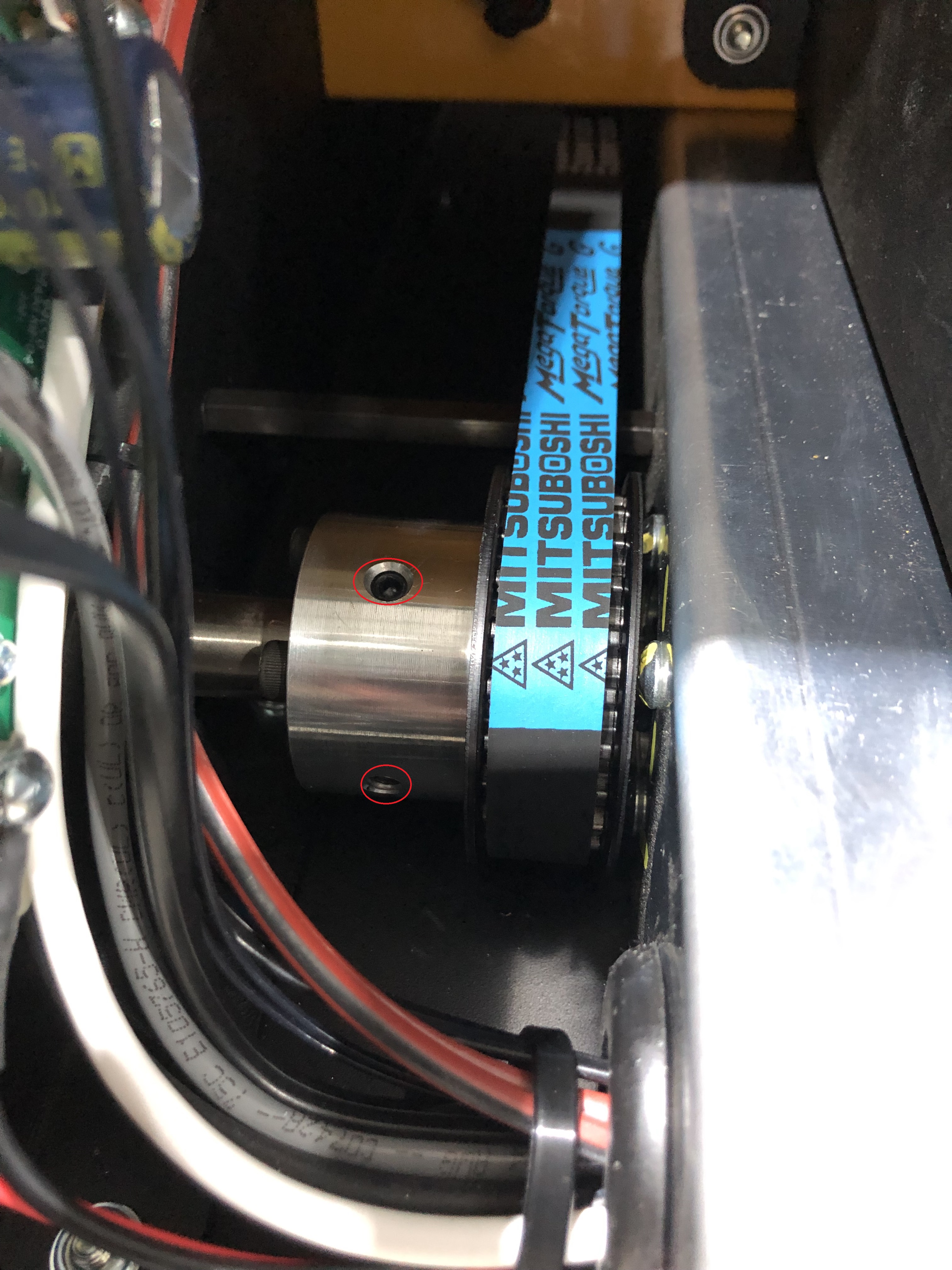

  • Tighten the marked grub screws.
_images/IMG_7444.webp

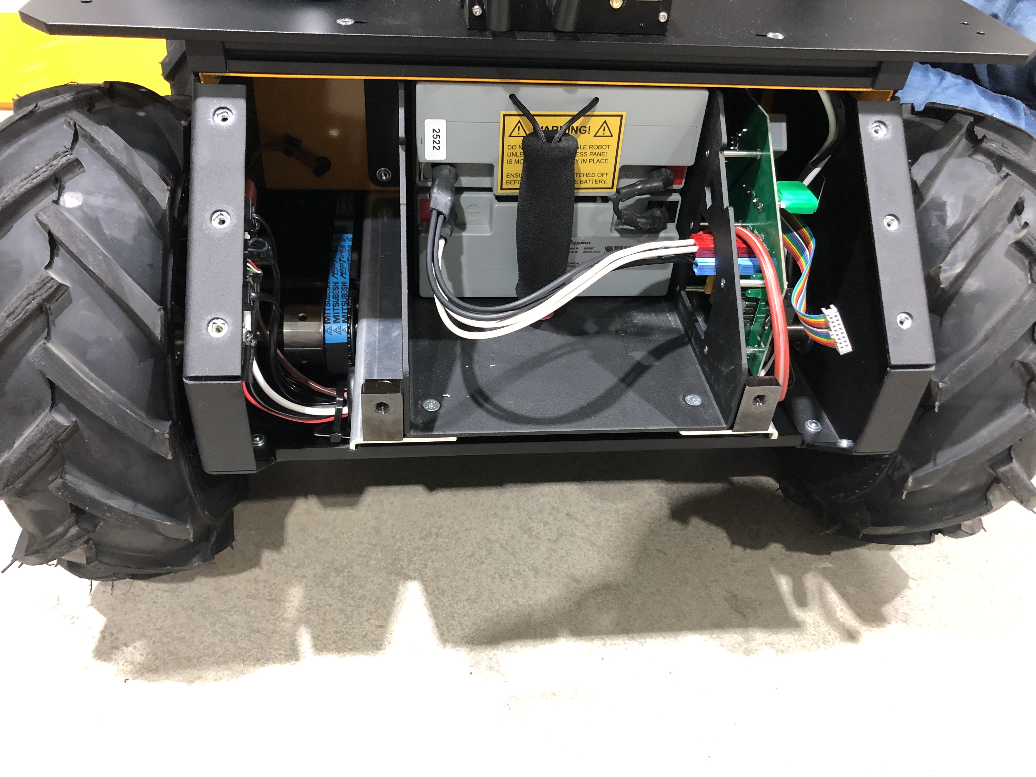

  • Please remove the back cover of the Husky.
_images/IMG_7441.webp

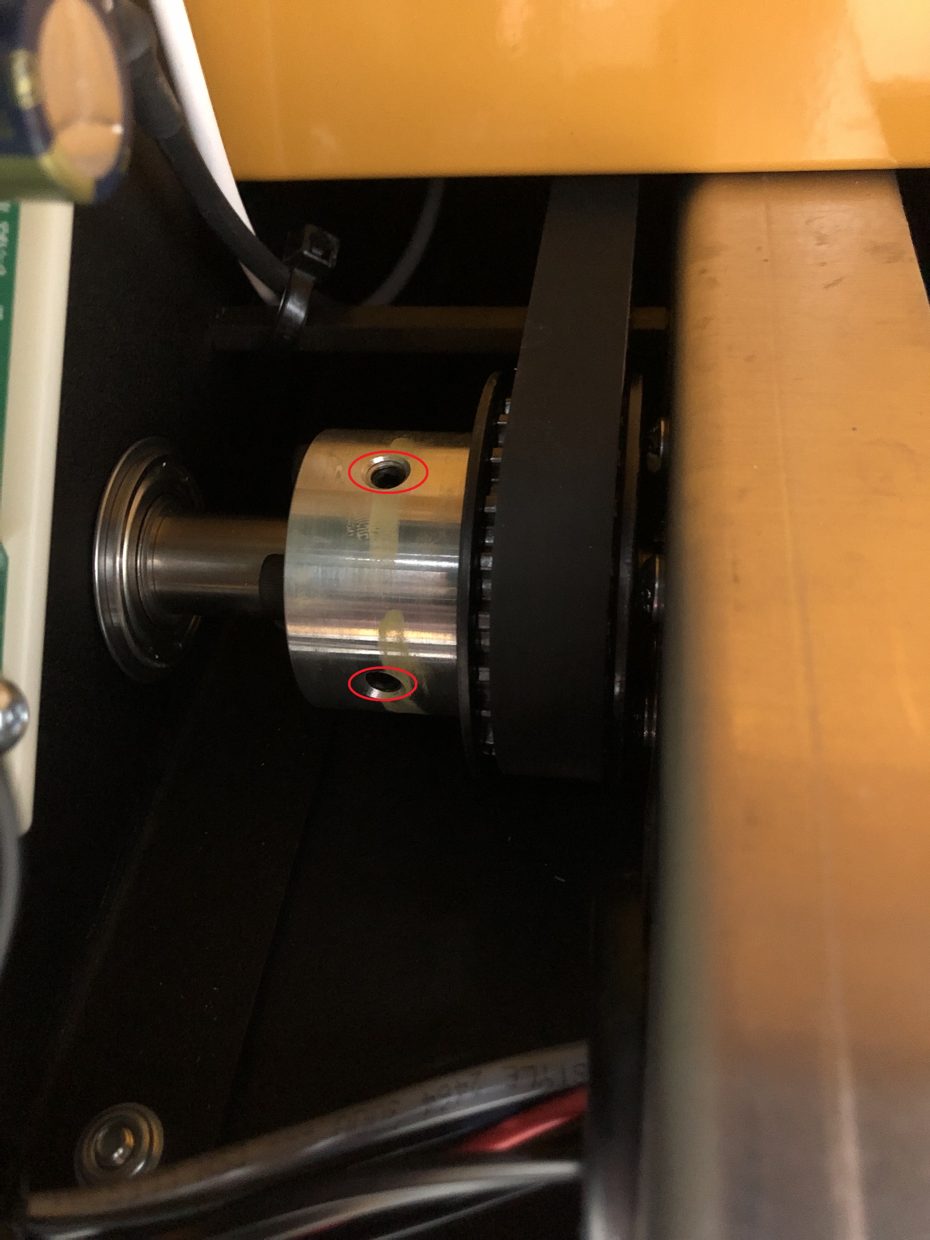

_images/IMG_7442.webp

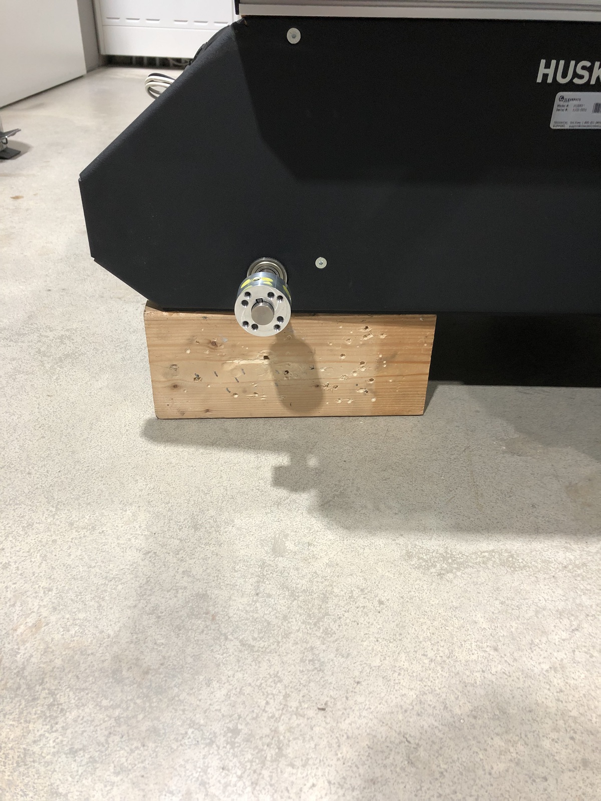

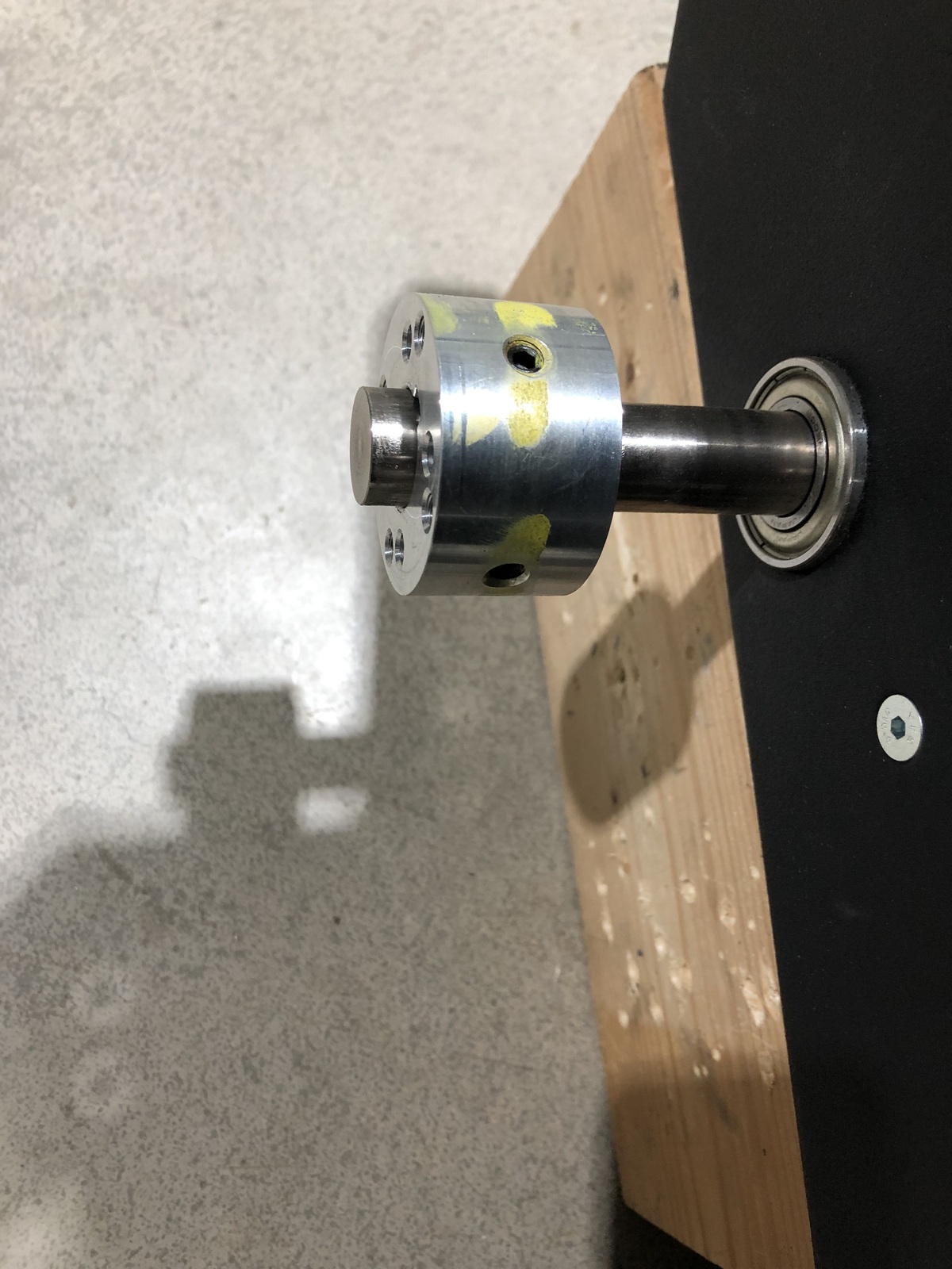

  • Additionally, you may have to tighten the Husky wheels grub screws.
_images/IMG_7445.webp
_images/IMG_7447.webp
