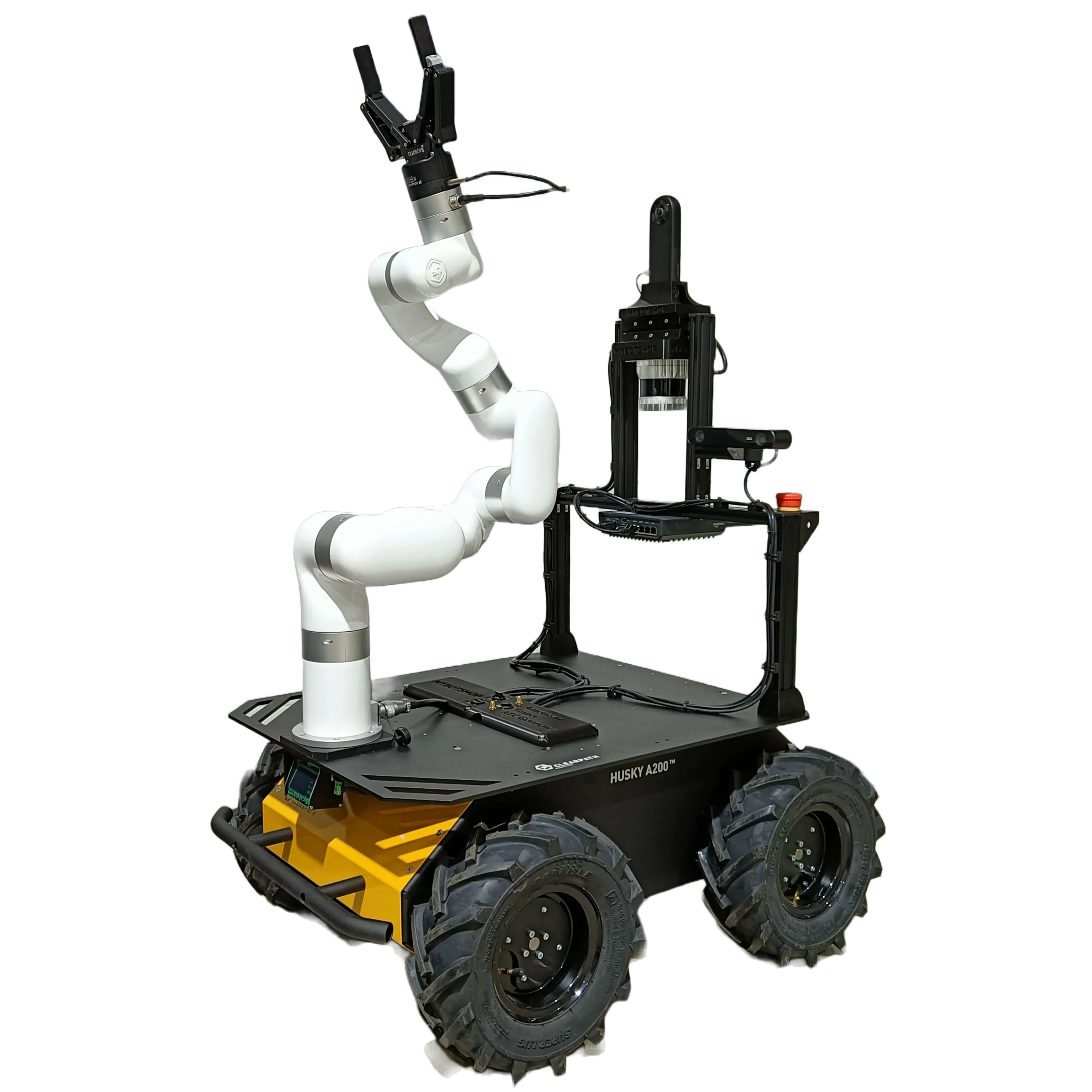

This specifies the configuration for Husky ATC. It has an Ouster lidar, Nvidia Orin, Zed2i depth camera, Cradlepoint Router, Qoocam, xARM6, Robotiq 2F-140 gripper, and Blickfeld Lidar.

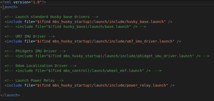

The launch file mbs_husky.launch in the catkin package of mbs_husky_startup includes everything which is being launched at the startup. Startup job and its content can be verified in the directory /etc/ros/noetic, here the original launch file will be copied.
Do not create multiple startup jobs with multiple launch files this will break the system. Only one launch file should be created and everything else should be included in this.
roslaunch mbs_husky_startup mbs_husky.launch
  1. Navigate and open mbs_husky_startup/launch/mbs_husky.launch.
_images/mbs_husky_launch.webp
  1. Add your custom node or launch file.
  2. Run the following script:
rosrun mbs_husky_startup startup_script.sh
  1. Verify if it is working correctly via:
sudo service mbs_husky status
Once you add your custom node or launch files in the mbs_husky.launch, you will need to run rosrun mbs_husky_startup startup_script.sh so that it updates the start-up job on the Husky’s PC otherwise it will not be updated.

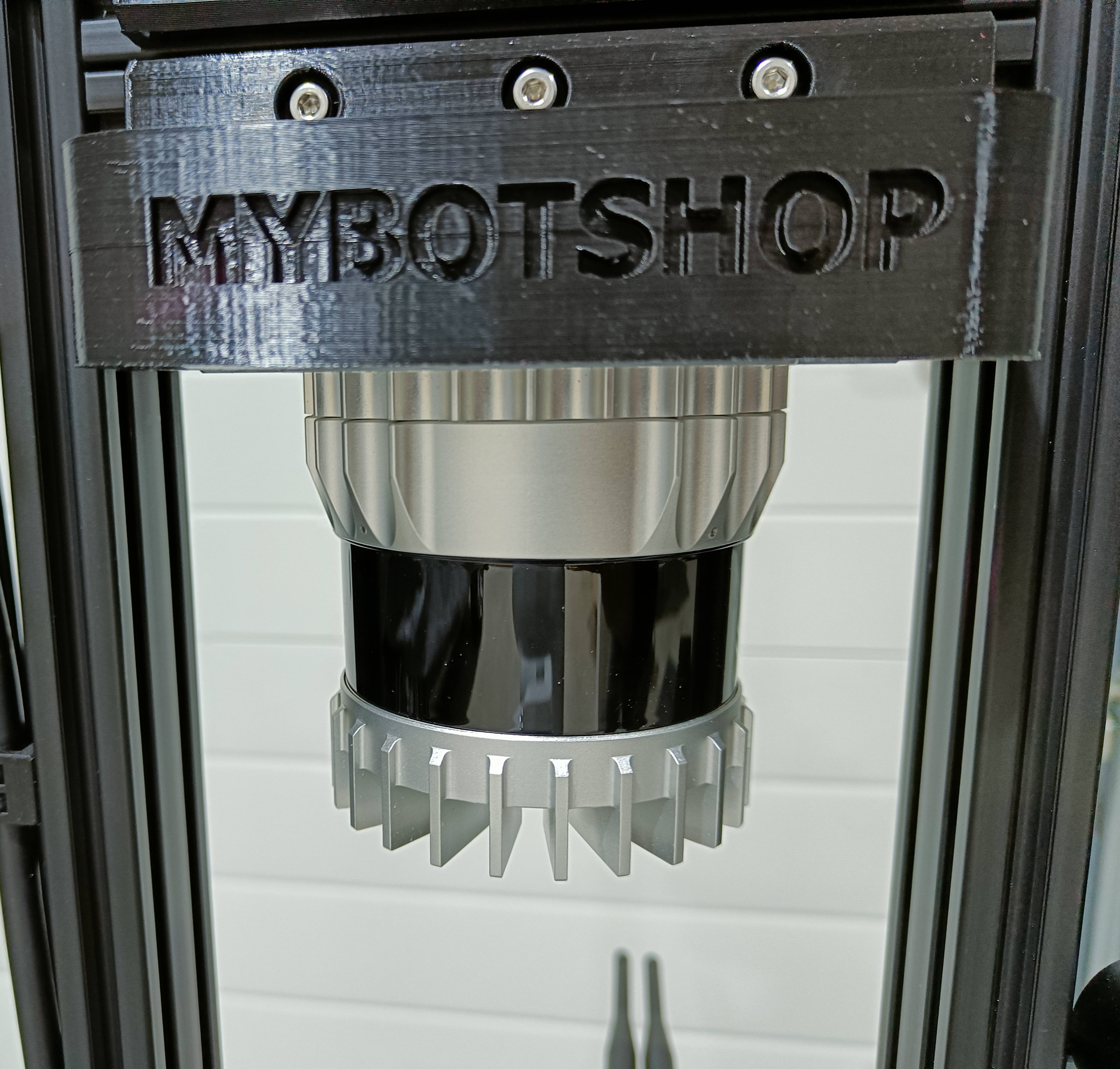

_images/husky_atc_ouster.webp
To manually launch the ouster driver, the following command can be used:
roslaunch mbs_lidars top_laser.launch
Please note that the lidars launch on start-up. Running it again will shut them down. They can be disabled by following the instuctions in the Custom Startup Job.

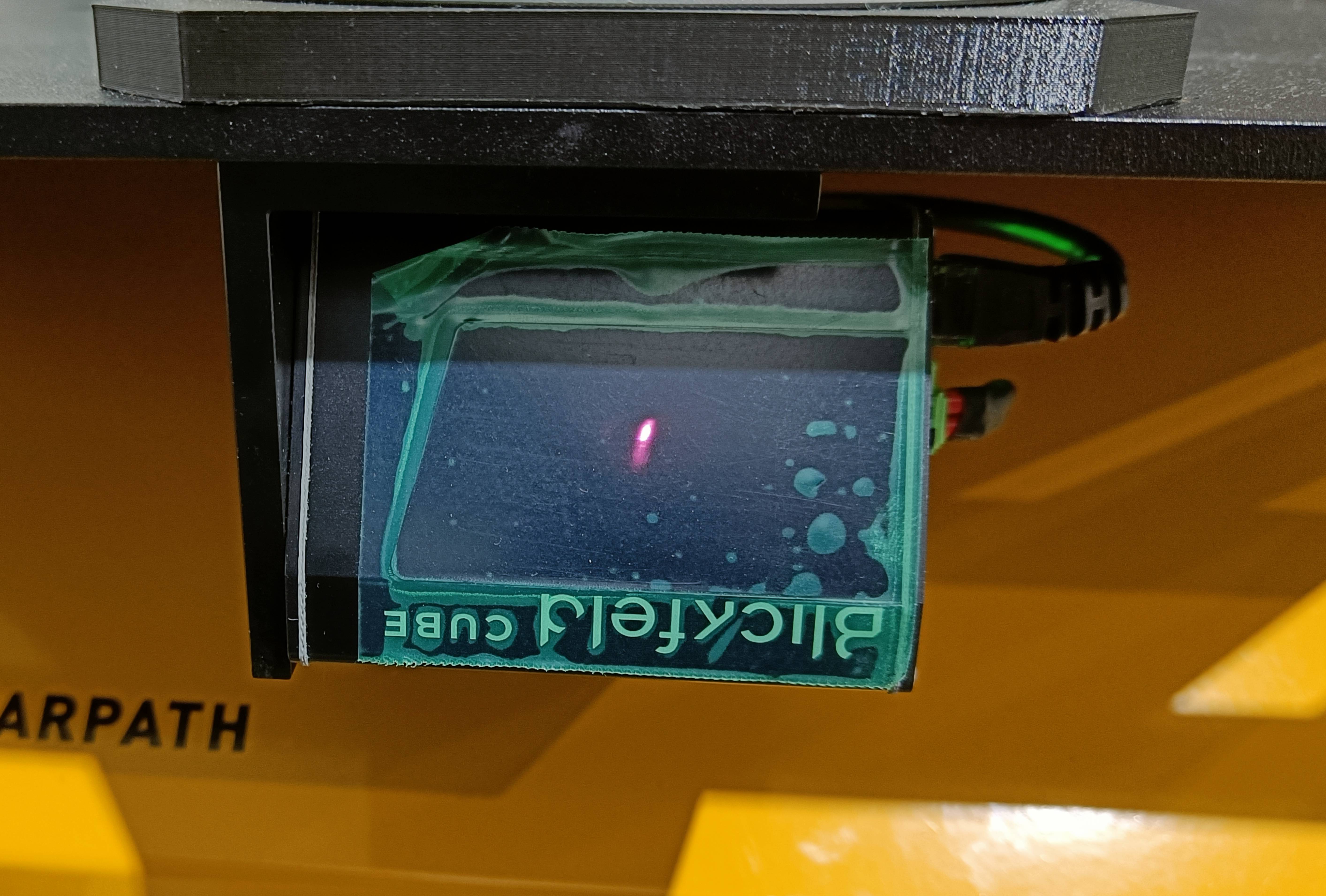

Blickfeld
_images/husky_atc_blickfeld.webp
To manually launch the blickfeld driver, the following command can be used:
roslaunch mbs_lidars front_laser.launch

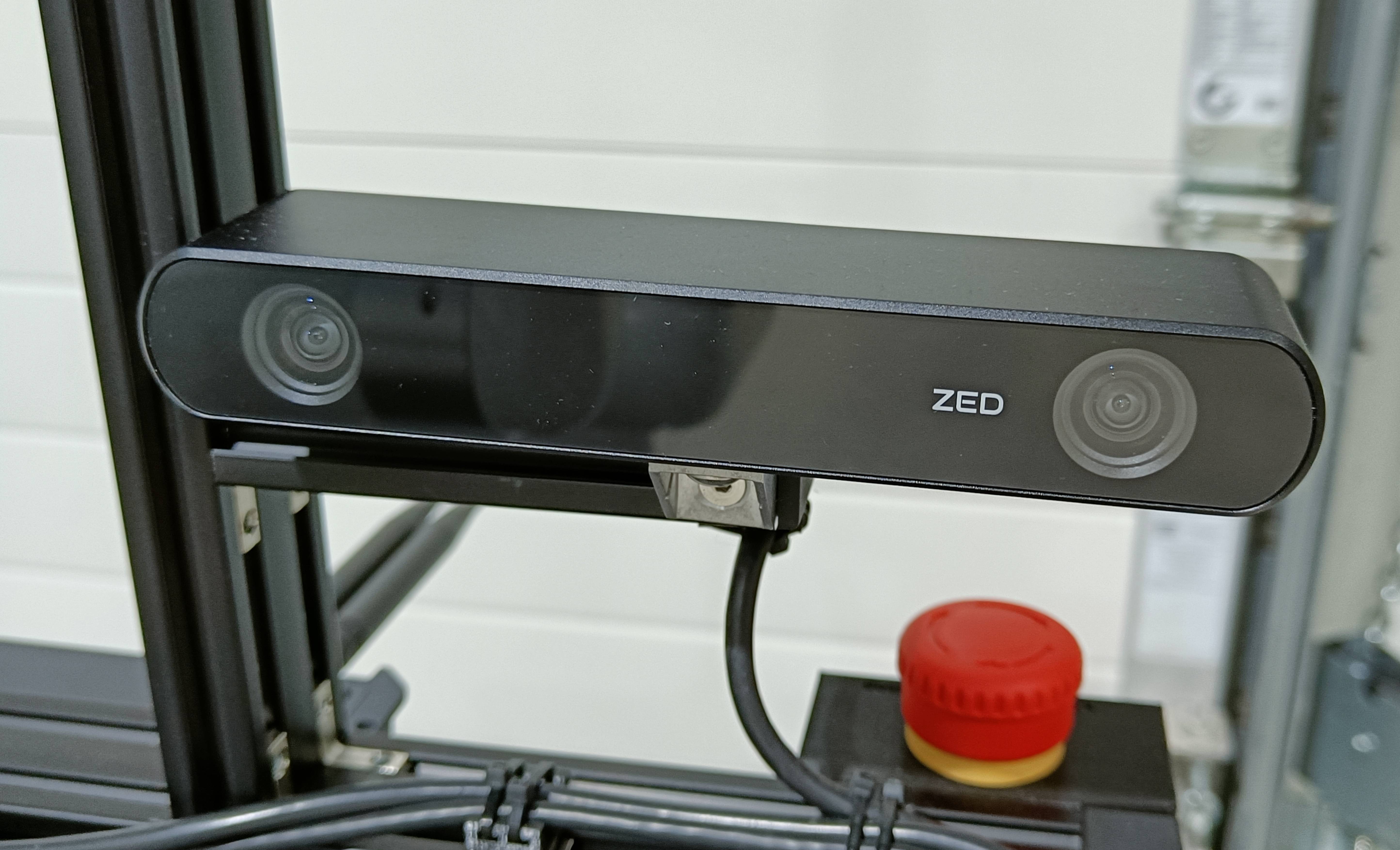

ZED2i
_images/husky_atc_zed2i.webp
On the robot start-up the Nvidia Orin starts, however, the Zed2i has to be manually launched.
  • ssh into the Nvidia Orin via:
ssh -X administrator@192.168.131.2
clearpath
  • To launch the ZED2i run the command.
roslaunch zed_wrapper zed2i.launch
Customization of the camera position can be done here via the launch file.
It may take upto a minute for all the drivers of the Nvidia to start. The stream for the ZED2 is transferred over to the main Husky PC via ROS multi machine. An example stream can be viewed rostopic echo /zed2/zed2_node/rgb/image_rect_color.
The information can be verified via:
rostopic list
The ZED2i requires USB 3.0 port and in the installed Nvidia board there is one available USB 3.0 port. So incase of removal please plug in the ZED2i into the same initial port it was in.

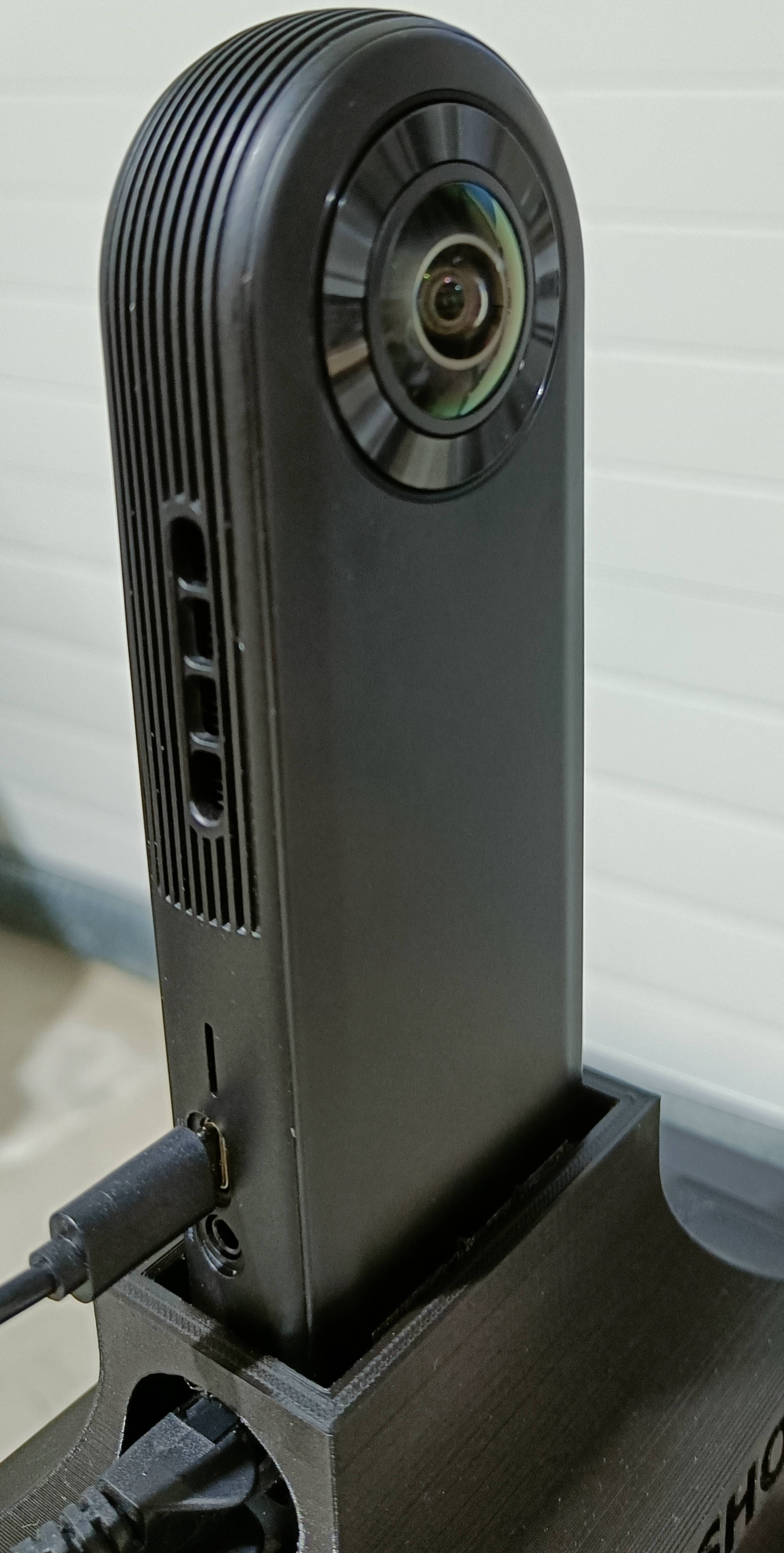

Qoocam
_images/husky_atc_qoocam.webp
To start the Qoocam driver.
  1. First you must power on the Qoocam by pressing the power button.
  2. Once Qoocam is powered on, swipe left on its touch screen and launch live mode.
  3. Ensure that the ethernet cable is connected. The router will automatically assign it the ip of 192.168.131.5.
  4. Click the middle button of the Qoocam to start the RTSP stream.
  5. Now launch the qoocam driver in the Husky via:
roslaunch mbs_qoocam qoocam_to_ros.launch
The driver will fail if it does not receive the camera stream.
Please note that the Qoocam has limited battery life and must be charged fully for optimal use.

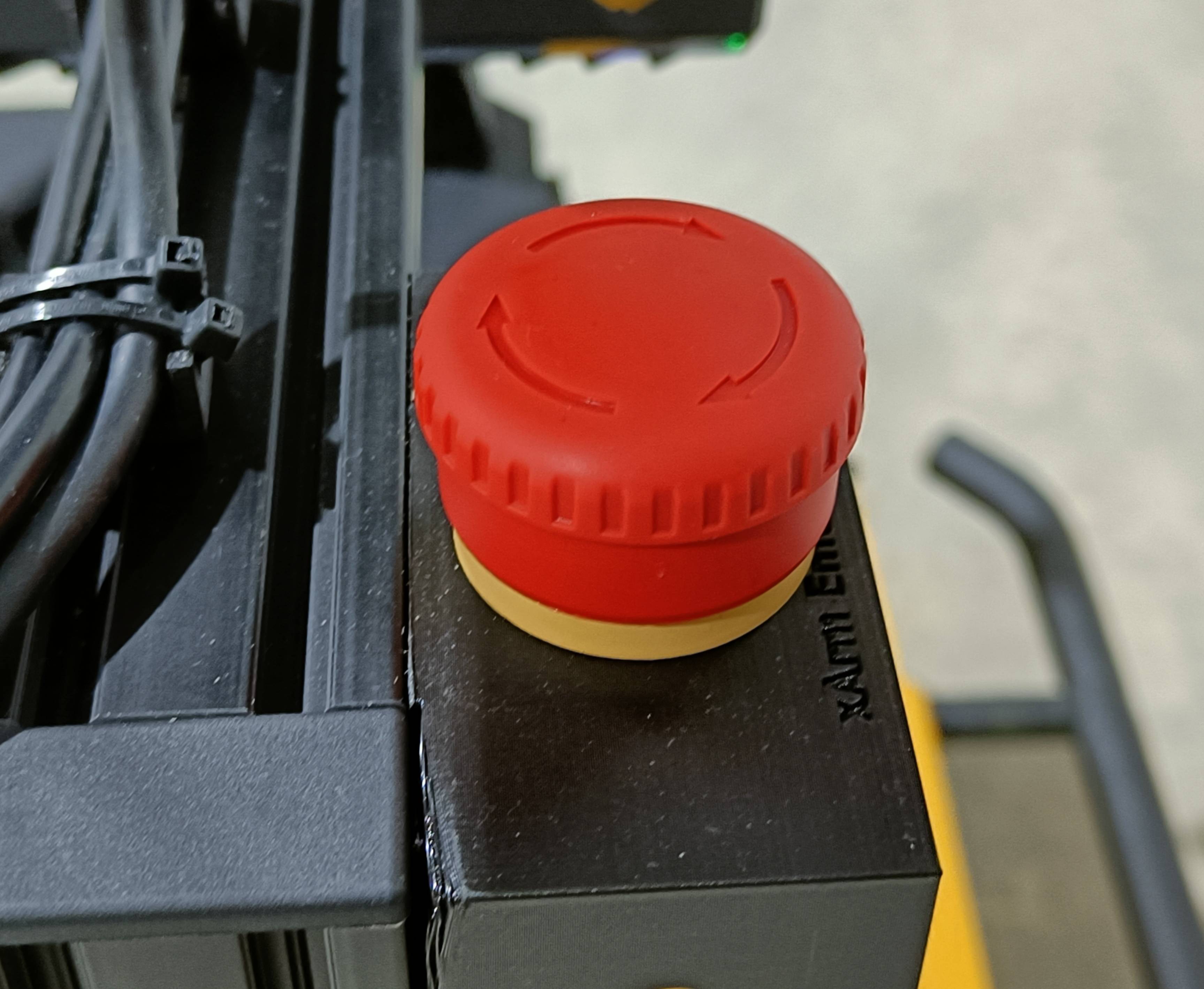

An emergency power cut-off for the xARM6 is available in the auxiliary frame of the Husky.
_images/husky_atc_emergencystop.webp

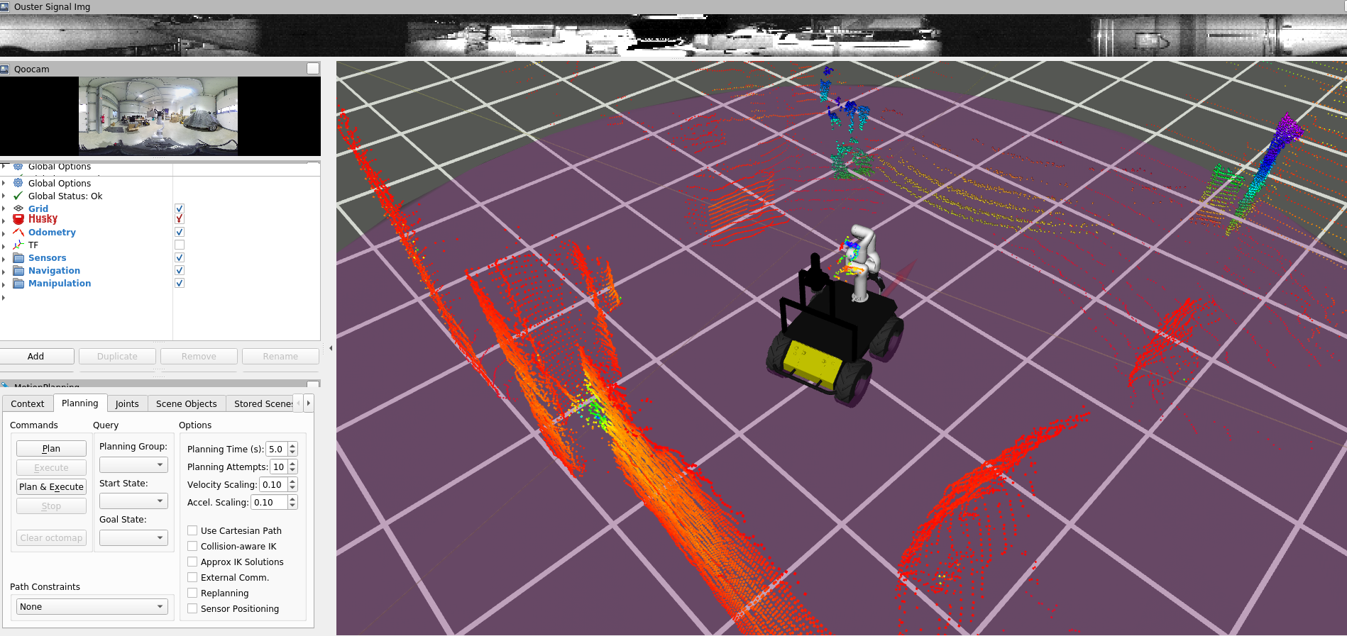

  • The visualize the robot model.
roslaunch mbs_viz viz.launch
_images/husky_atc_viz.webp
