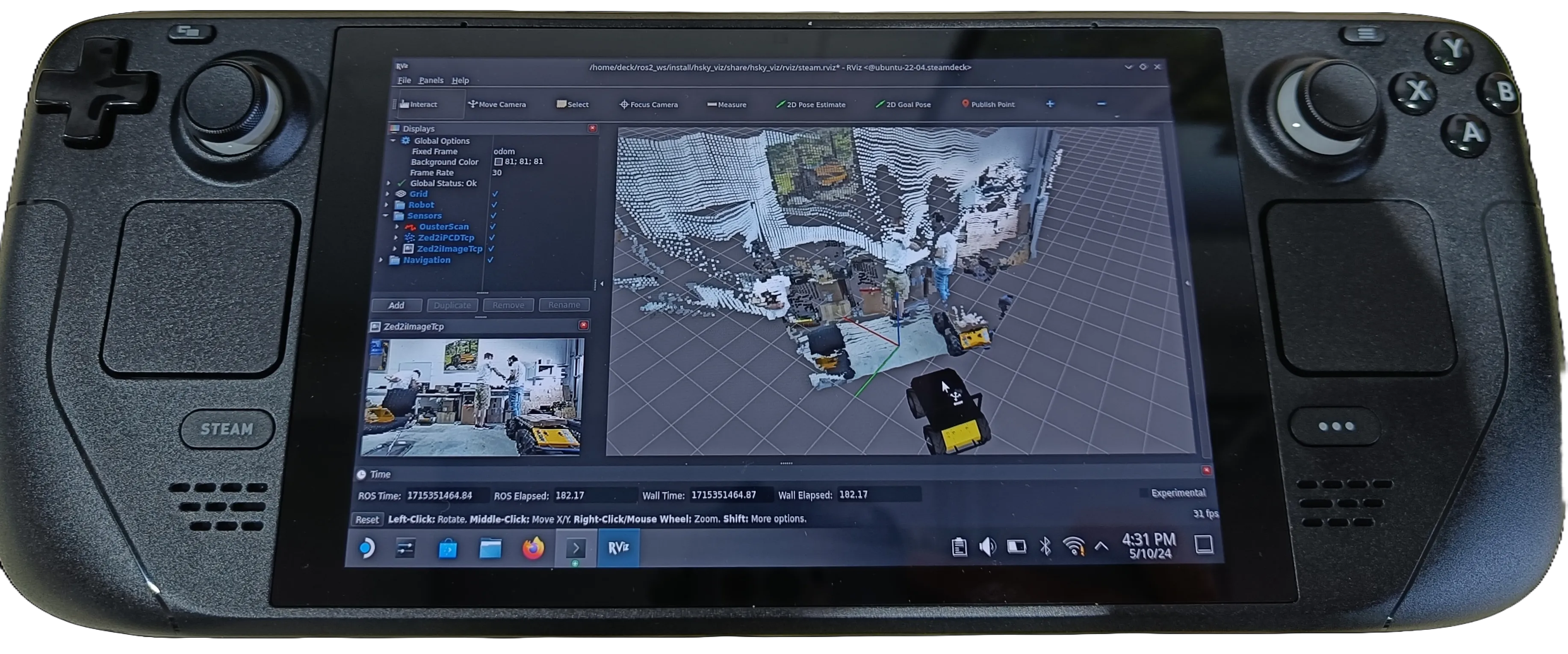

  3. Press Y + Up arrow to activate the ZED2i Depth camera.
  4. Use Y + Down arrow to deactivate the ZED2i Depth camera.
