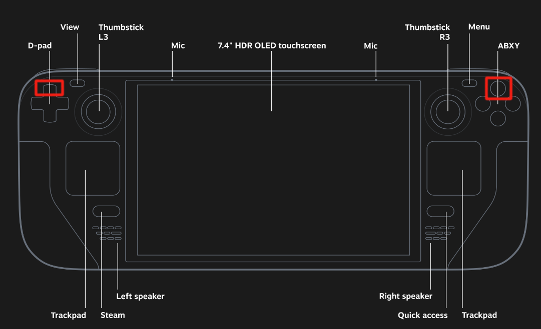

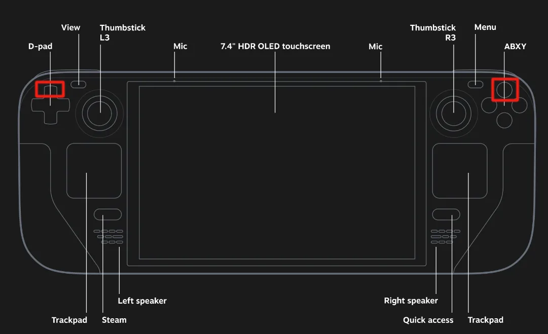

  3. Press Y + Up arrow to activate the ZED2i Depth camera.
  4. Use Y + Down arrow to deactivate the ZED2i Depth camera.

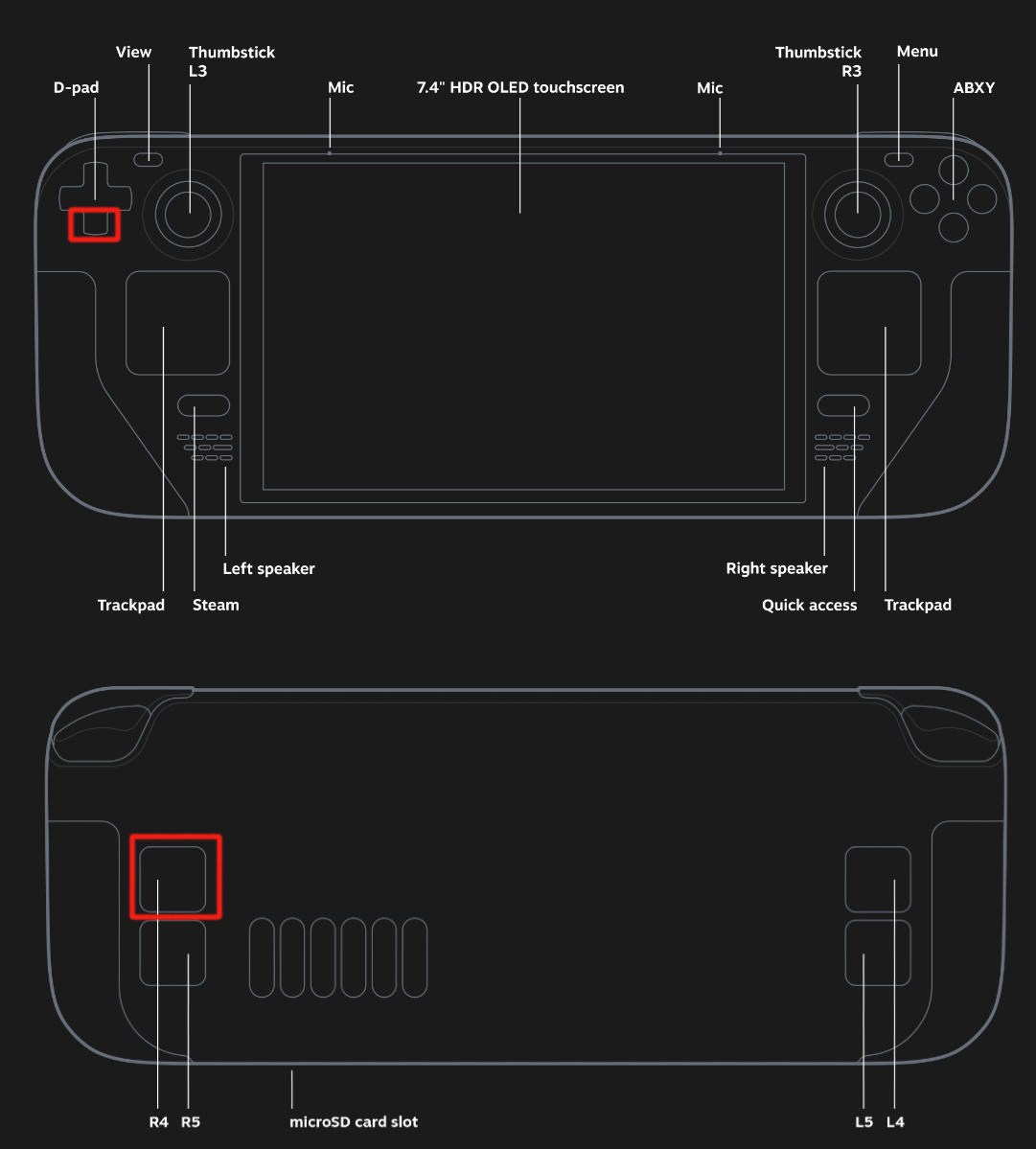

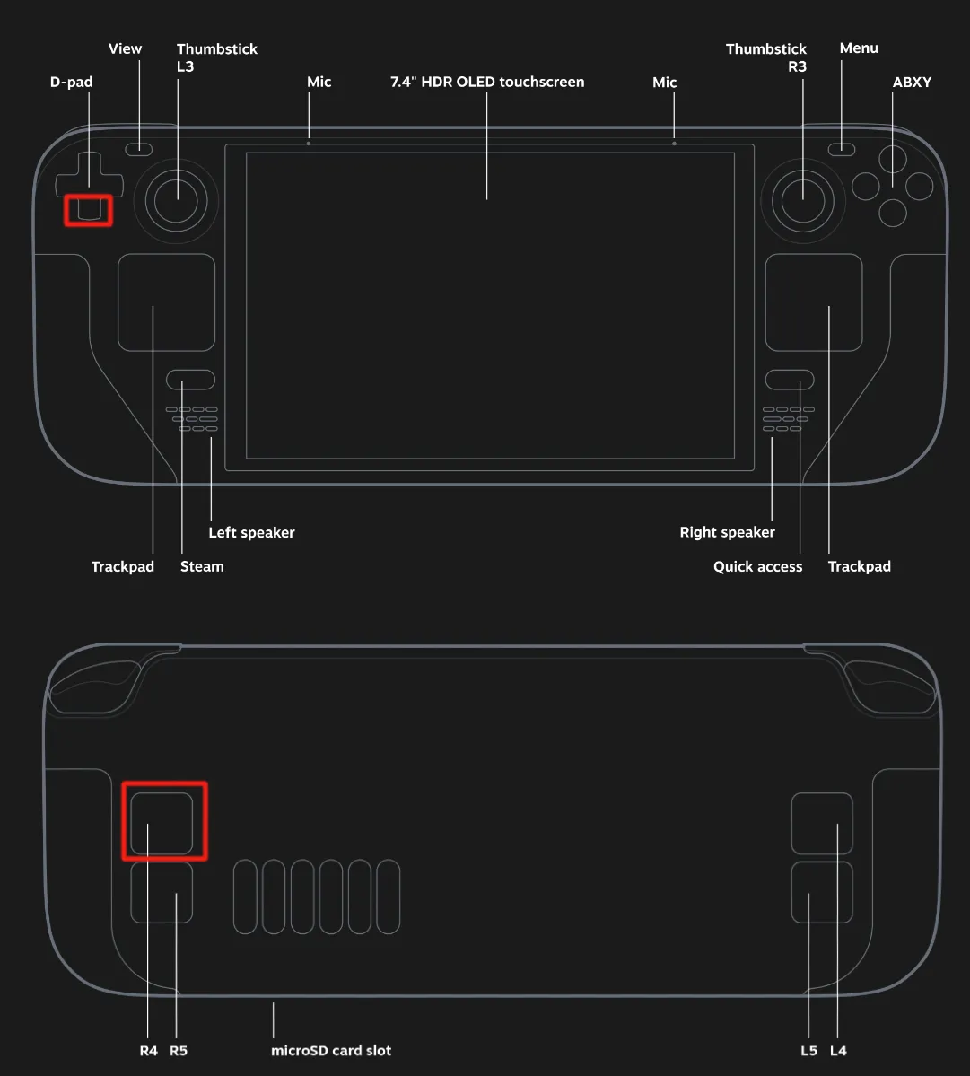

  5. Press R4 + Up arrow to activate the Ouster Lidar.
  6. Use R4 + Down arrow to deactivate the Ouster Lidar.

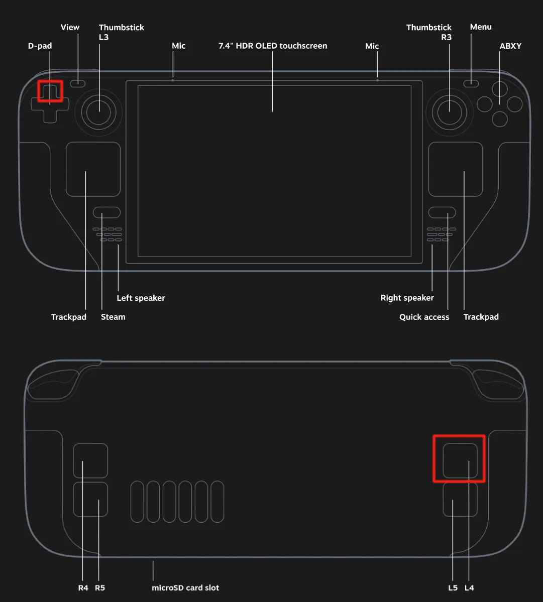

  7. Press L4 + Up arrow to activate the Fixposition GPS.
  8. Use L4 + Down arrow to deactivate the Fixposition GPS.
