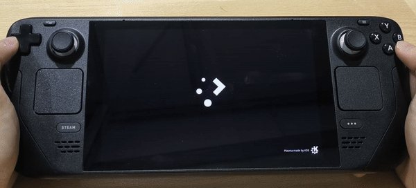

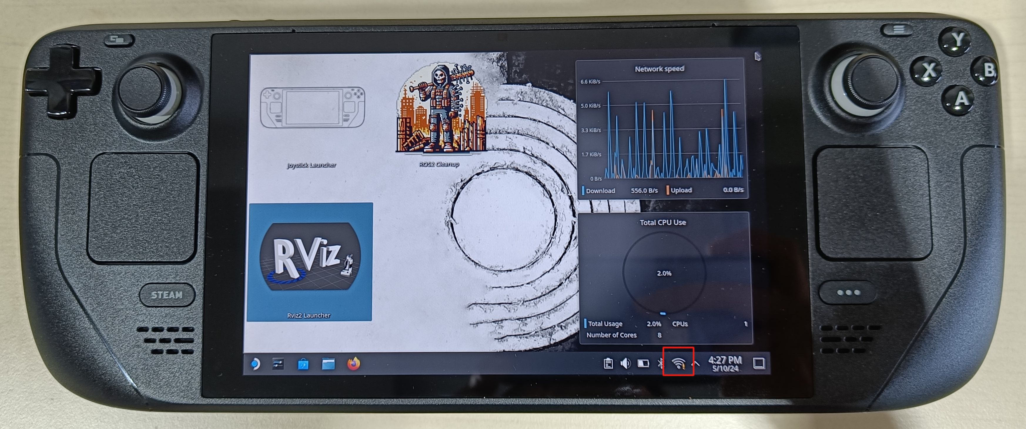

  1. Confirm that the Steam Deck is connected to the robot’s WiFi access point.
    _images/sd33.jpg
    ■ This process is automated.

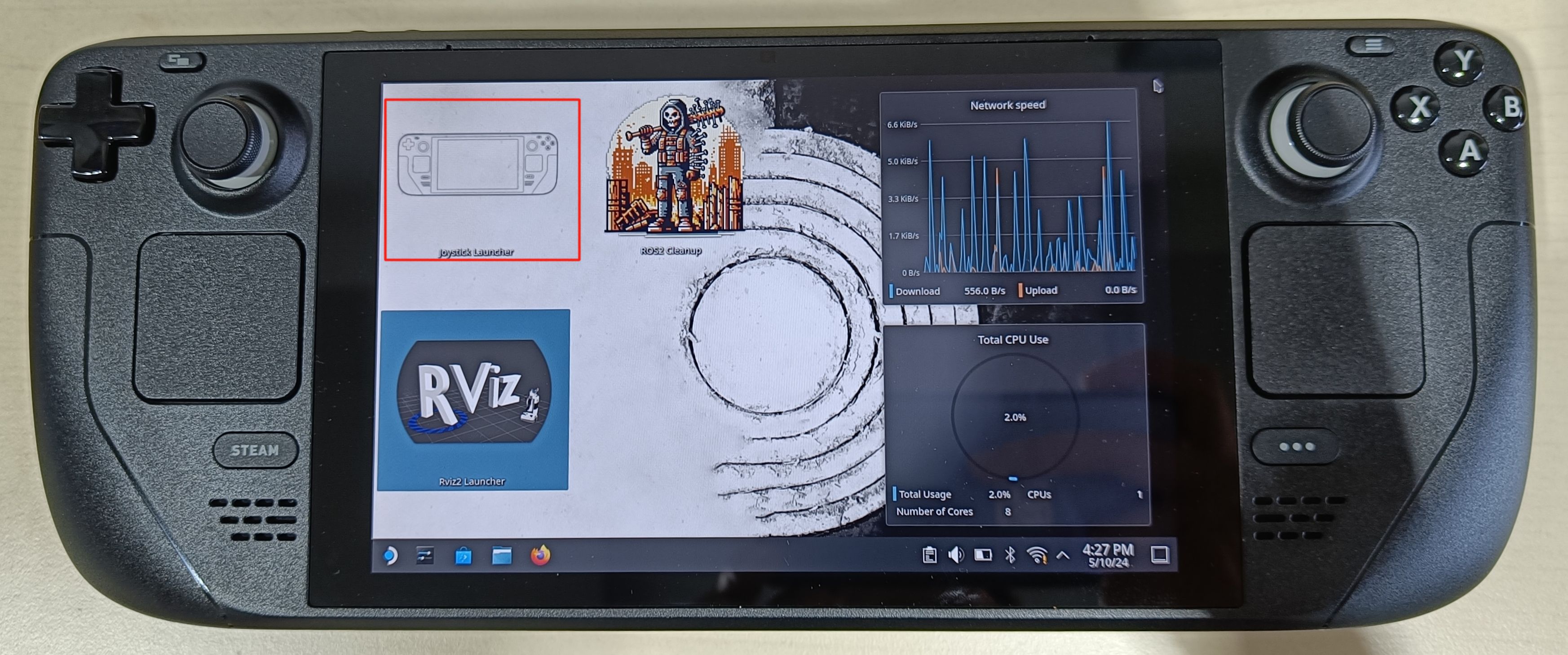

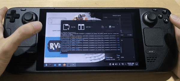

  3. Simply tap the Joystick Launcher icon on the screen to activate the controller for the robot.
    _images/sd34.jpg
    _images/sd1.gif

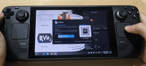

    ■ Avoid opening multiple instances of the Joystick Launcher to prevent the generation of unwanted nodes.
    ■ Press - - - icon if the mouse stops working/freezes when launching the Joystick Launcher.
    _images/sd35.png
    _images/sd3.gif

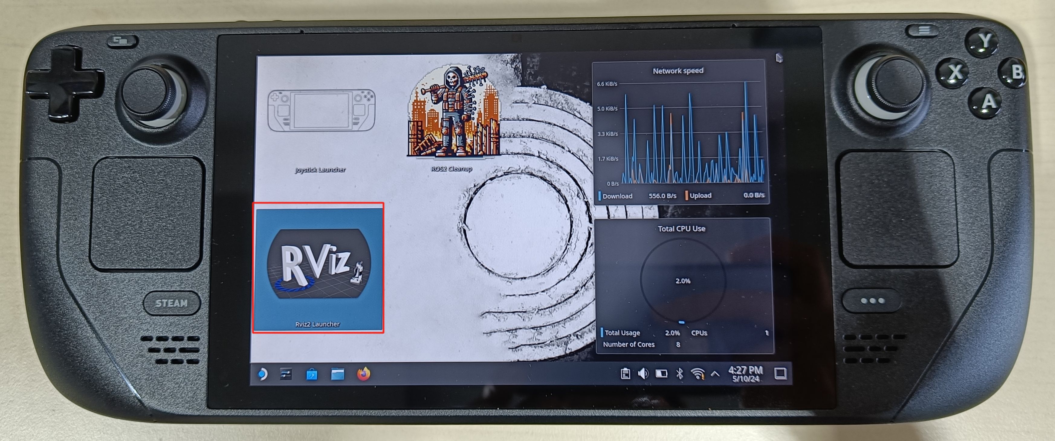

  4. Tap once on the RViz2 Launcher icon to visualize the robot.
