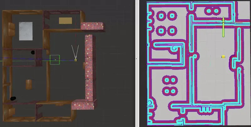

  1. Straight-Line Movement - The robot adhered closely to the planned trajectory with minimal drift. - Smooth motion was achieved by tuning parameters such as max_velocity and yaw_goal_tolerance.
    Straight-Line Movement GIF

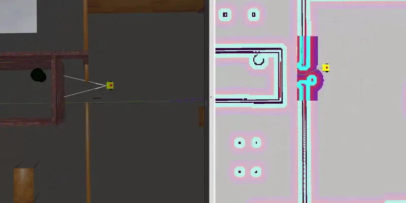

  2. Static Obstacles - The robot slowed down at the junction and adjusted its speed. - Trajectory adjustments were made by the robot, and it remained on the global path. - Minor path deviations were corrected by the local controller.
    Static Obstacles GIF

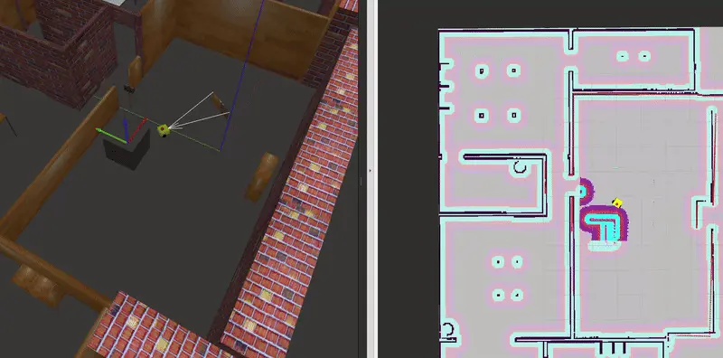

  3. Dynamic Obstacles - The robot successfully responded to a moving cube as a placeholder for a moving person but exhibited slight delays when encountering faster objects. - The robot did not collide with the moving cube. - The robot did not maintain a safe distance, likely due to suboptimal tuning of parameters such as inflation_radius, PathDist.scale, or obstacle_max_range in the local and global costmaps.
    Dynamic Obstacles GIF
