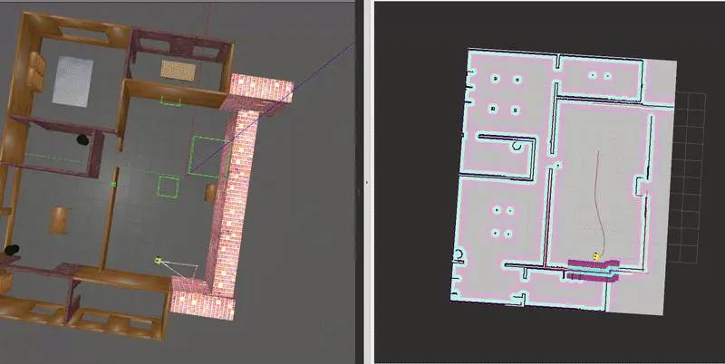

Straight-Line Movement - The robot performed satisfactorily, following a smooth and direct path. - No significant deviations or delays were observed.

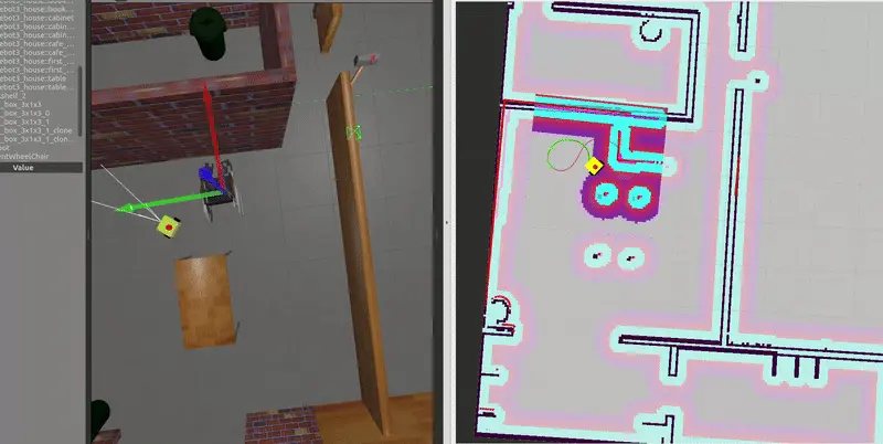

Navigating Static Obstacles - The Smac Planner generated a longer path to avoid obstacles. - As the robot approached the goal, it took additional time to stabilize. - The robot struggled slightly when passing through narrow gaps between walls, experiencing delays due to repeated replanning.

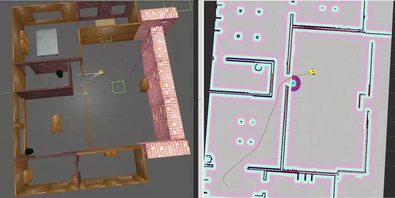

Navigating Dynamic Obstacles - The robot detected a moving wheelchair but was less robust in avoiding it compared to the NavFn + MPPI combination. - Multiple replanning attempts were necessary to successfully navigate around the obstacle. - Despite these challenges, the robot ultimately reached the goal.
