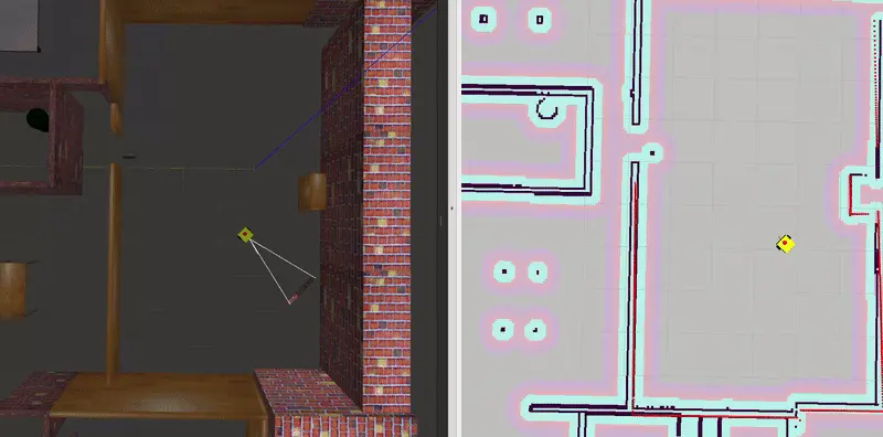

  1. Straight-Line Movement - The robot followed a smooth and precise trajectory with minimal drift. - Real-time trajectory optimization ensured stable motion.

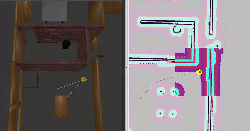

  2. Navigating Static Obstacles - The controller successfully adjusted the robot’s path to avoid obstacles, maintaining smooth transitions. - Dynamic trajectory optimization minimized unnecessary deviations.

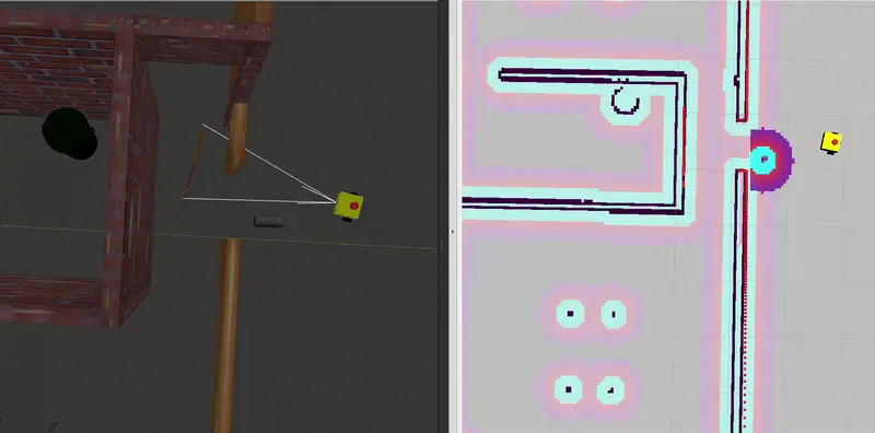

  3. Navigating Dynamic Obstacles - The robot responded effectively to moving obstacles, recalculating the trajectory in real time. - The robot maintained a safe distance from the moving object. - Optimized control commands reduced delays in avoiding faster-moving objects.
