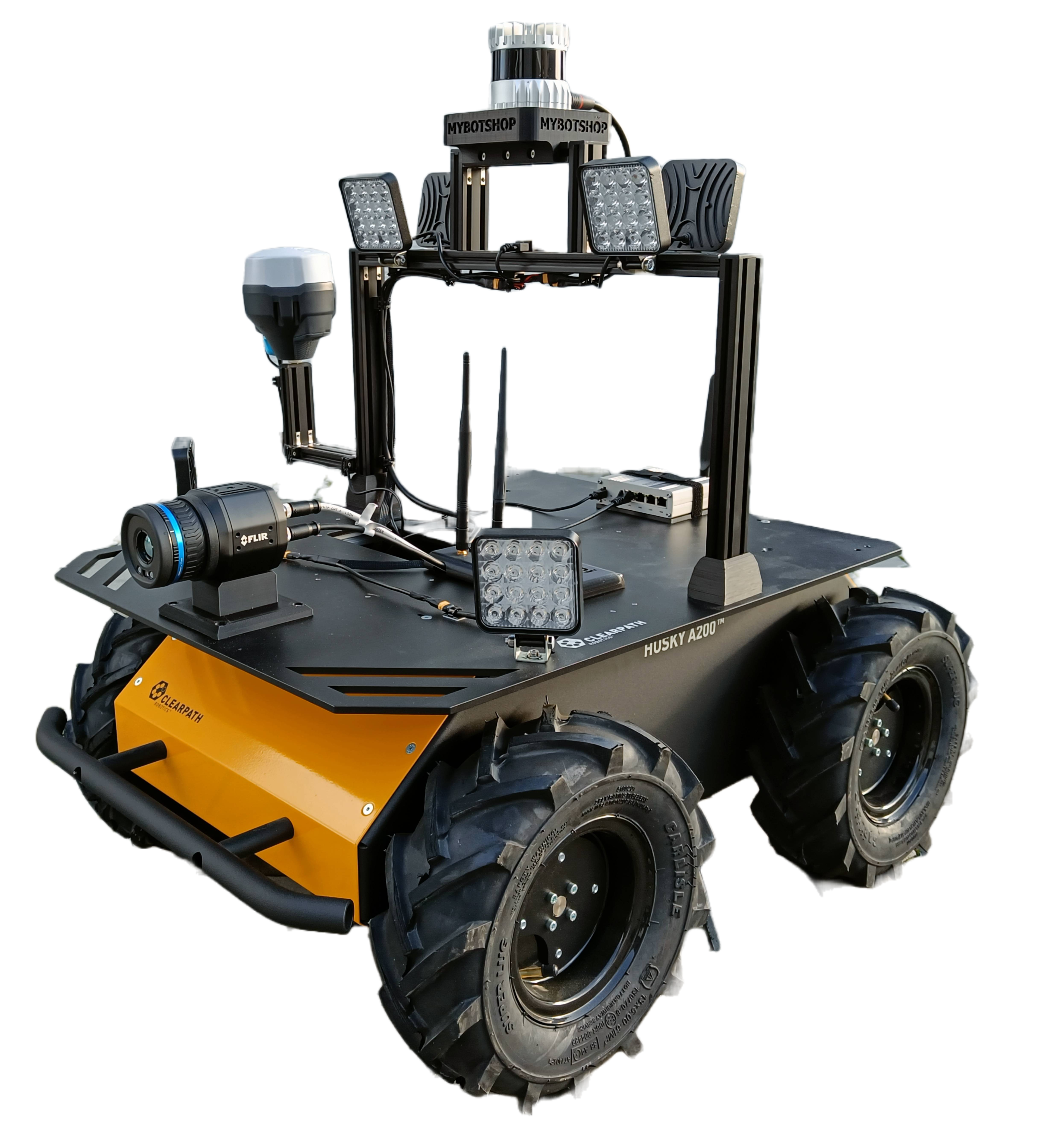

Husky MI
_images/husky_mi.webp
This specifies the configuration for Husky MU. It has an ouster lidar, reach rs2 gps (rover), reach rs2 gps (base), (NRE) light systems, Lord Microstrain IMU, and long range router.
To setup-up the Husky, the instructional video playlist can be used which details the opening and use of the Husky.
On husky startup the following driver is started:
  • Husky base driver
The Ouster is powered on as well but the driver has to be manually started (can be automated as explained in Custom Startup Job) to ensure that the husky base driver starts up quickly. The Emlid hardware as well as the driver does not start on startup either (The hardware can be configured to start on startup via the mobile app).
Both Emlid and Ouster driver run when either of the following commands are run:
roslaunch mbs_navigation odom_navigation.launch
roslaunch mbs_gps_navigation gps_navigation.launch

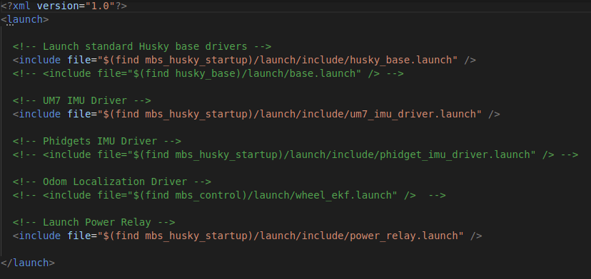

The launch file mbs_husky.launch in the catkin package of mbs_husky_startup includes everything which is being launched at the startup. Startup job and its content can be verified in the directory /etc/ros/noetic, here the original launch file will be copied.
Do not create multiple startup jobs with multiple launch files this will break the system. Only one launch file should be created and everything else should be included in this.
roslaunch mbs_husky_startup mbs_husky.launch
  1. Navigate and open mbs_husky_startup/launch/mbs_husky.launch.
_images/mbs_husky_launch.webp
  1. Add your custom ros node or launch file. Please note the image might differe but the procedure is the same.
An optional step is to launch the file to test if everything is working via: roslaunch mbs_husky_startup mbs_husky.launch
  1. Run the following script:
rosrun mbs_husky_startup startup_script.sh
  1. Verify if it is working correctly via:
sudo service mbs_husky status
Once you add your custom node or launch files in the mbs_husky.launch, you will need to run rosrun mbs_husky_startup startup_script.sh so that it updates the start-up job on the Husky’s PC otherwise it will not be updated.

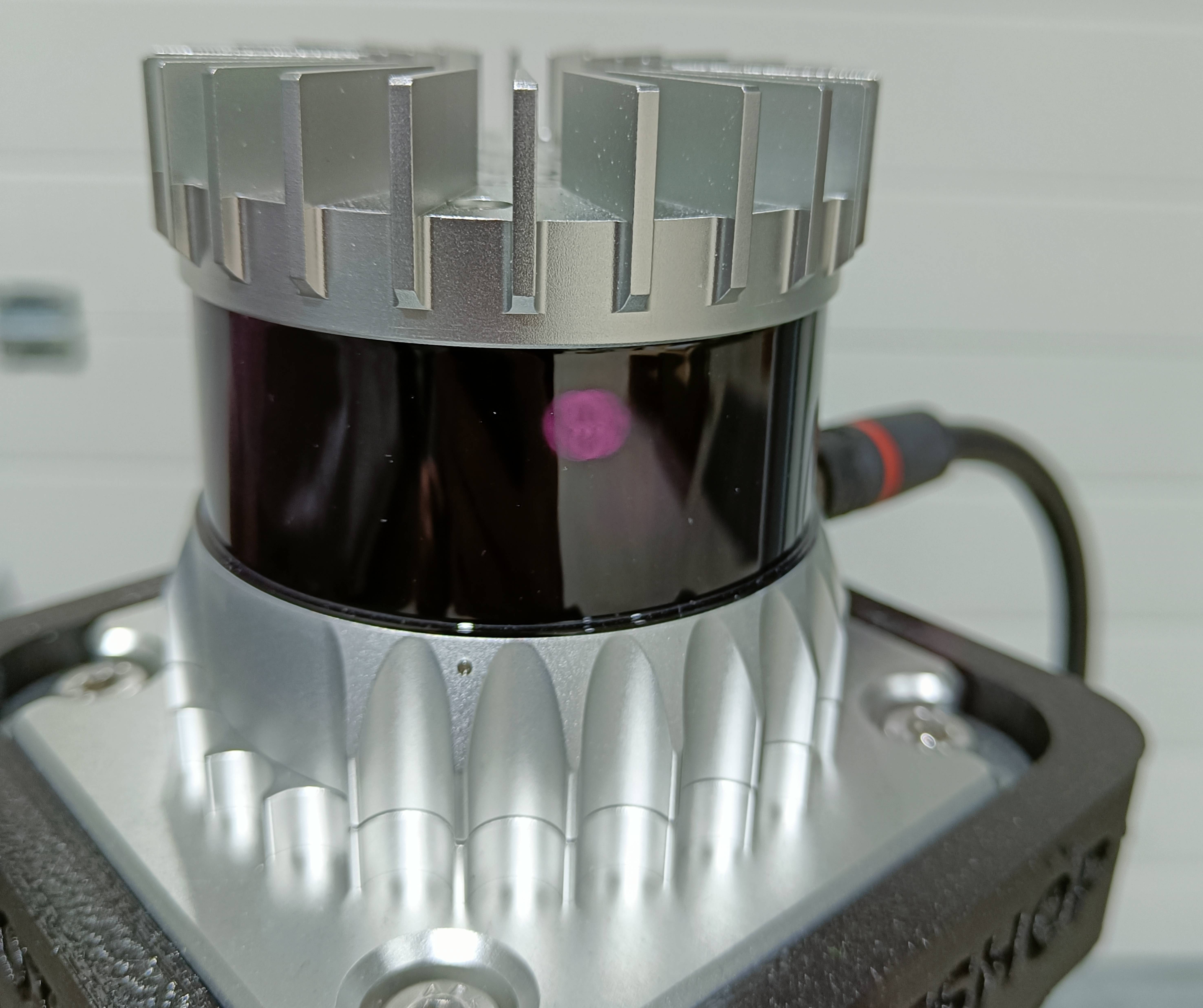

_images/husky_mi_ouster.webp
To manually launch the ouster driver, the following command can be used:
roslaunch mbs_ouster ouster.launch
Please note that the ouster is launched with the odom_navigation and gps_navigation launch files as well.

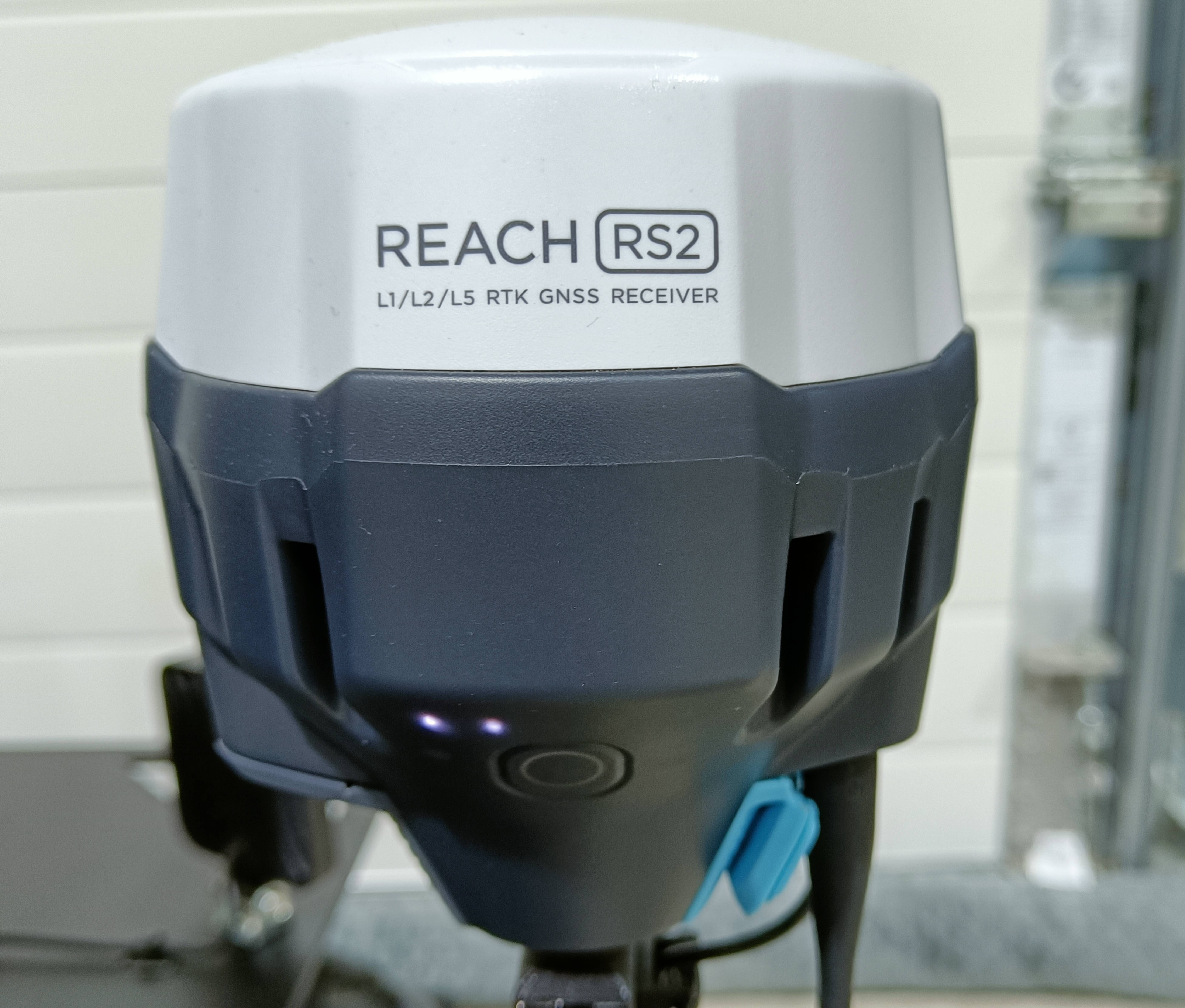

EMLID RS2 Rover
_images/husky_mi_emlid.webp
To start the Emlid Reach RS2 driver separately, run:
roslaunch mbs_utilities reach_rs.launch
The Emlid RS2 should be on for this operation to work. By default it does not startup with Husky (can be done via the browser). Press and hold the emlid and when the blue leds of link are solid, then it means it has botted up and is linked.

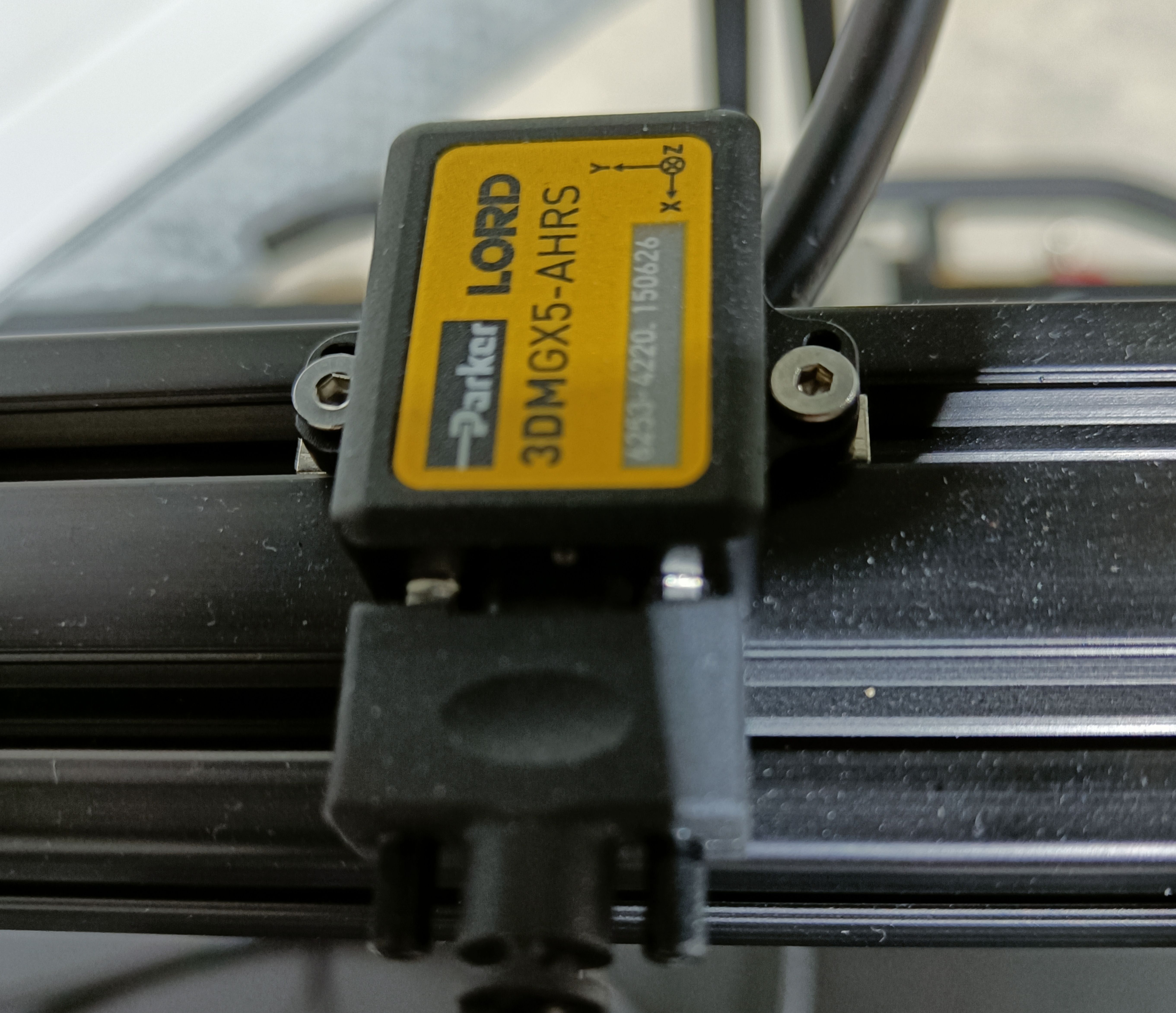

_images/lord_microstrain_imu.webp
It starts up be default. The parameters can be modified for the sensor fusion of the IMU with the Husky in the mbs_control/config/wheel_ekf.yaml package. The driver for the imu is in the mbs_husky_startup/launch/include/microstrain.launch

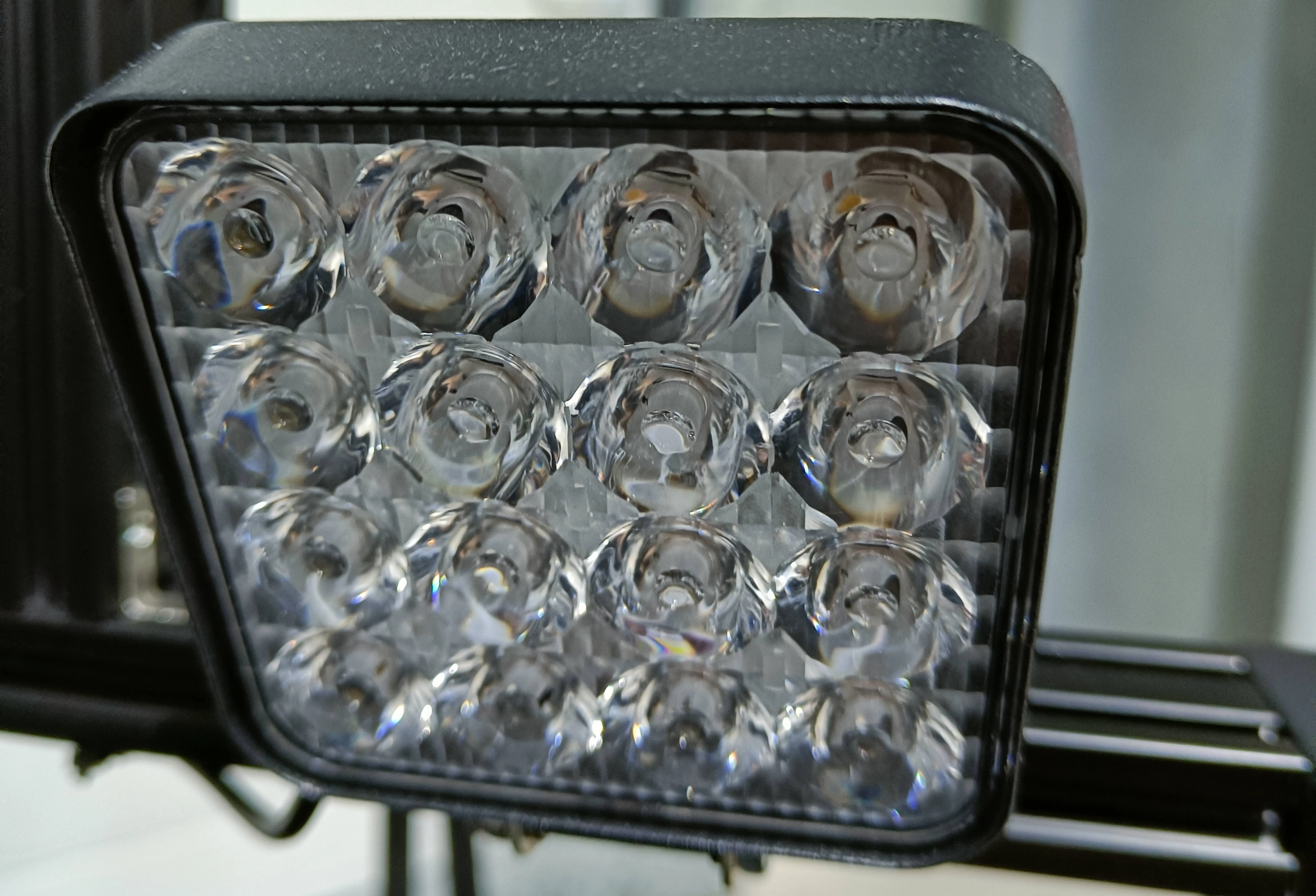

(NRE) Light System
_images/husky_mi_lamps.webp
An arduino is activating the (6X) 45W Led Off-Road Lights on the XT60 connector. The Arduino is connected to the /dev/ttyUSB0 port which is detected by a UDEV rule.
When the robot starts, the arduino starts which controls the lights via the main PC in the husky. A startup script starts the communication between the Arduino and the main PC in the husky. To check the status of this module, the following steps are to be performed:
  • We can check the status of the power-relay node via:
  • If the icon is green, it means that the packages have started without any issues.
_images/green_status.webp
  • In the event of an error, you may restart this startup job via:
sudo service mbs_husky restart
(NRE) Light System ROS Control
  • Swtich on/off the lights, run the command:
rosservice call /set_lights "front: true
rear: false
top: false"

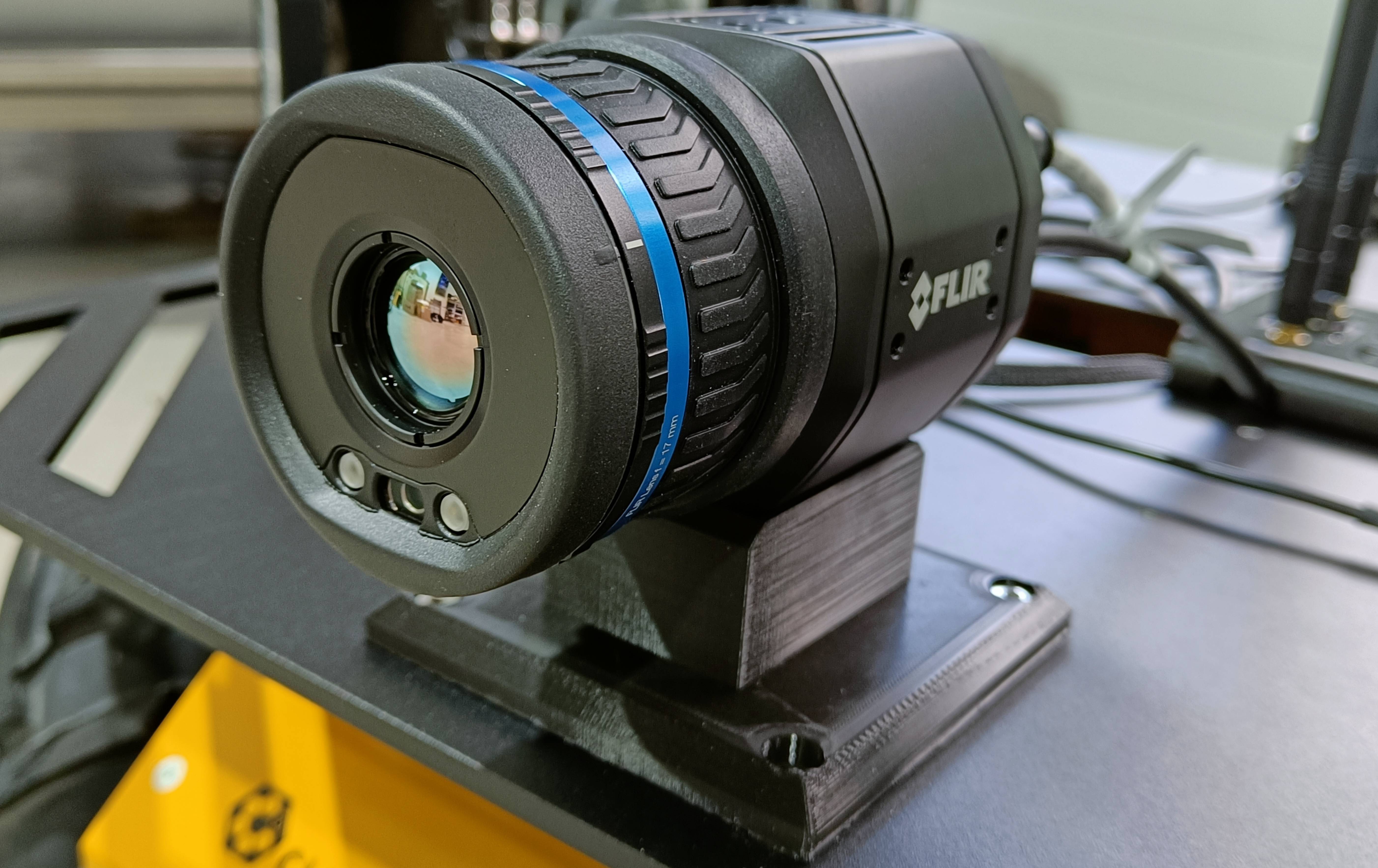

Flir
_images/flir.webp
To launch the flir driver, the following command can be used:
roslaunch mbs_flir flir_driver.launch
The web interface can be accessed by the ip 192.168.131.2. The username and password is given in the operation section.
