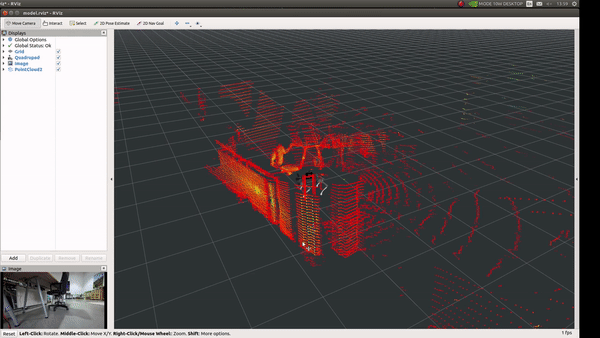

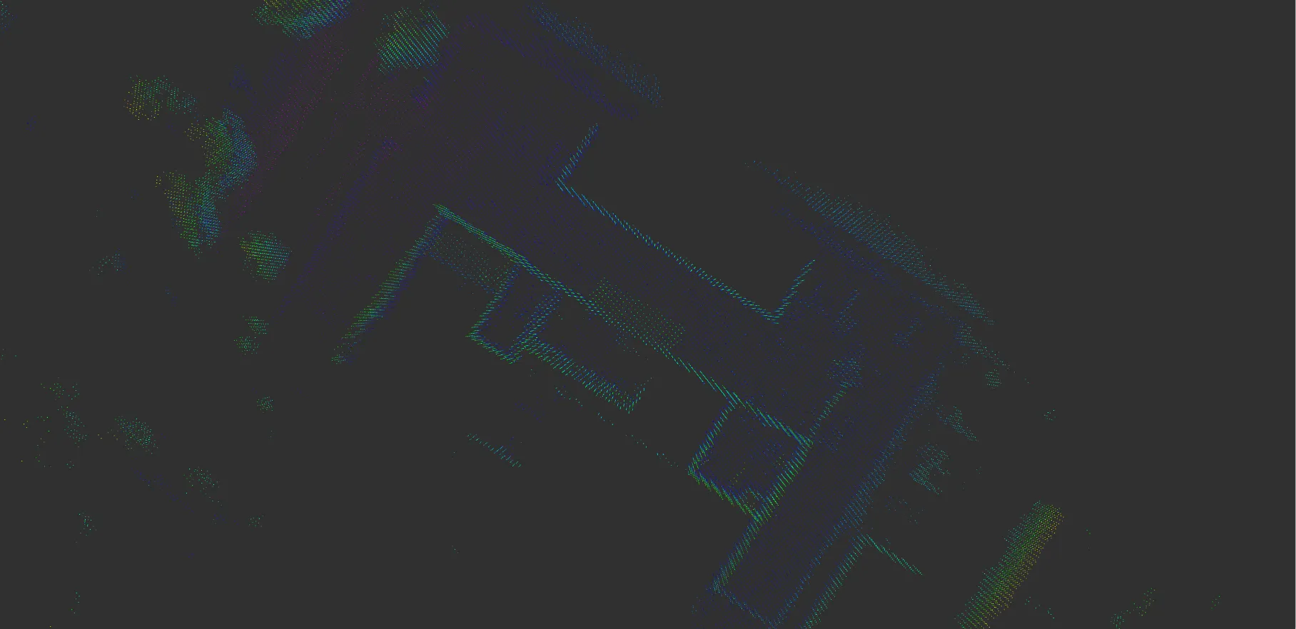

3D-Mapping
_images/husky_massive_pcd.webp

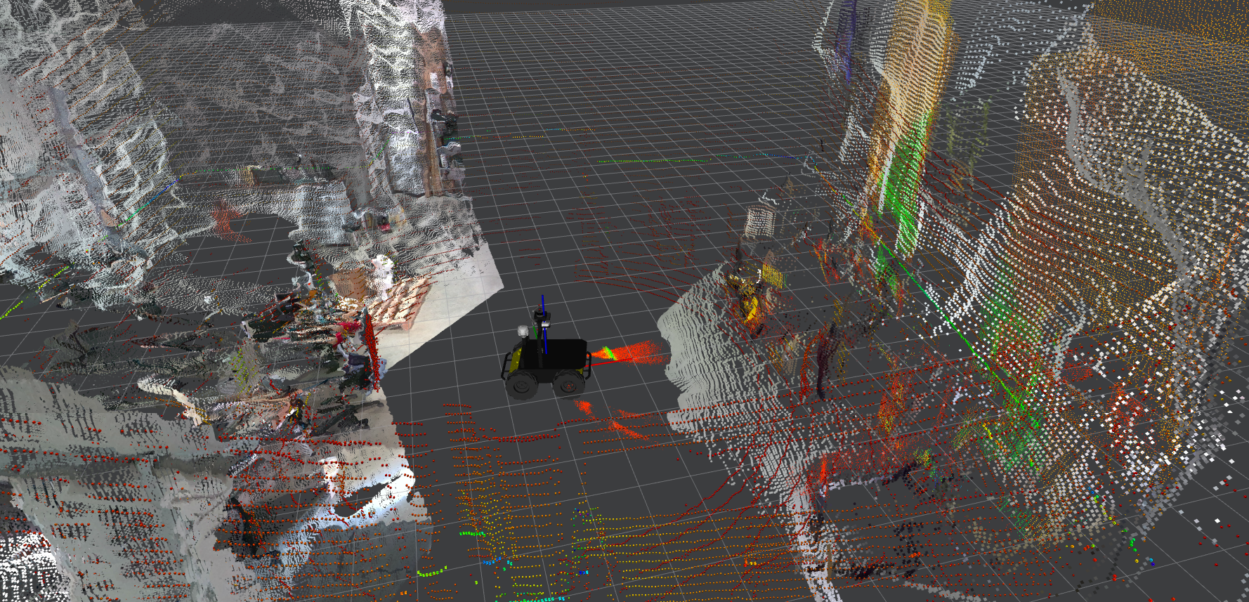

_images/outdoor_pointcloud.webp
