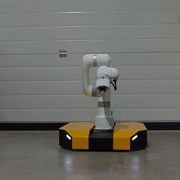

As the Dingo-D Lite6 is a multi-robot system consisting of Lite6 and Lite6 gripper, hence, the Lite6 Guides are applicable.
For the Lite6 ROS drivers please refer to the ufactory github section. To aid in manipulation tasks please refer to the examples in the mmp_bringup/scripts/mmp_example.py. For recommended manipulation please refer to roswiki moveit.

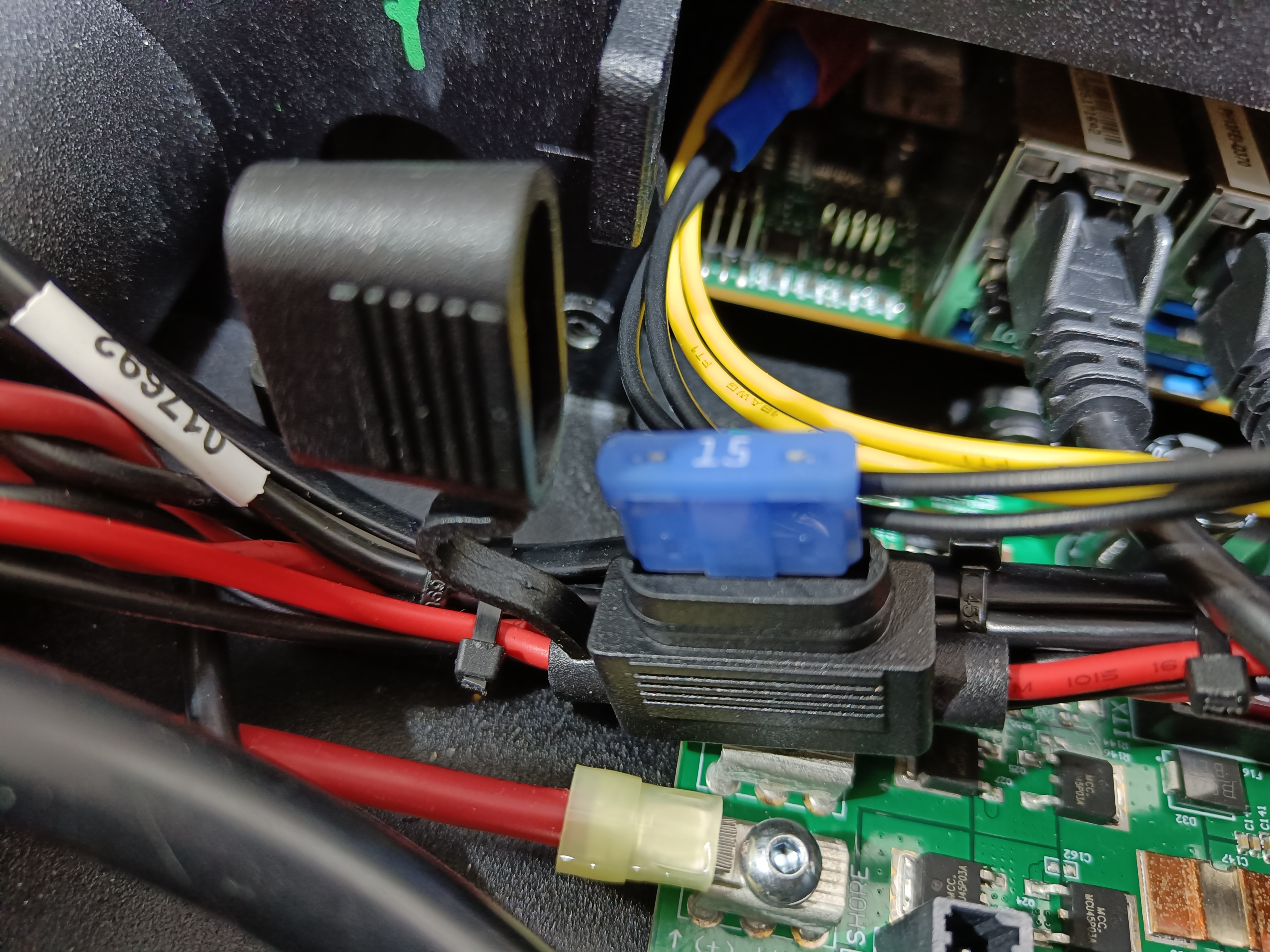

Lite6 Power Fuse
_images/lite6_fuse.webp
The Lite6 is powered on by Dingo-D’s power. For safety reasons a 15 Amp fuse is installed. Incase that there is a surge of power the fuse will trigger and will have to be replaced. To replace it, simply open the Dingo-D’s central hatch located under the Lite6, open the rubber cover that is over the MCU and replace the fuse.

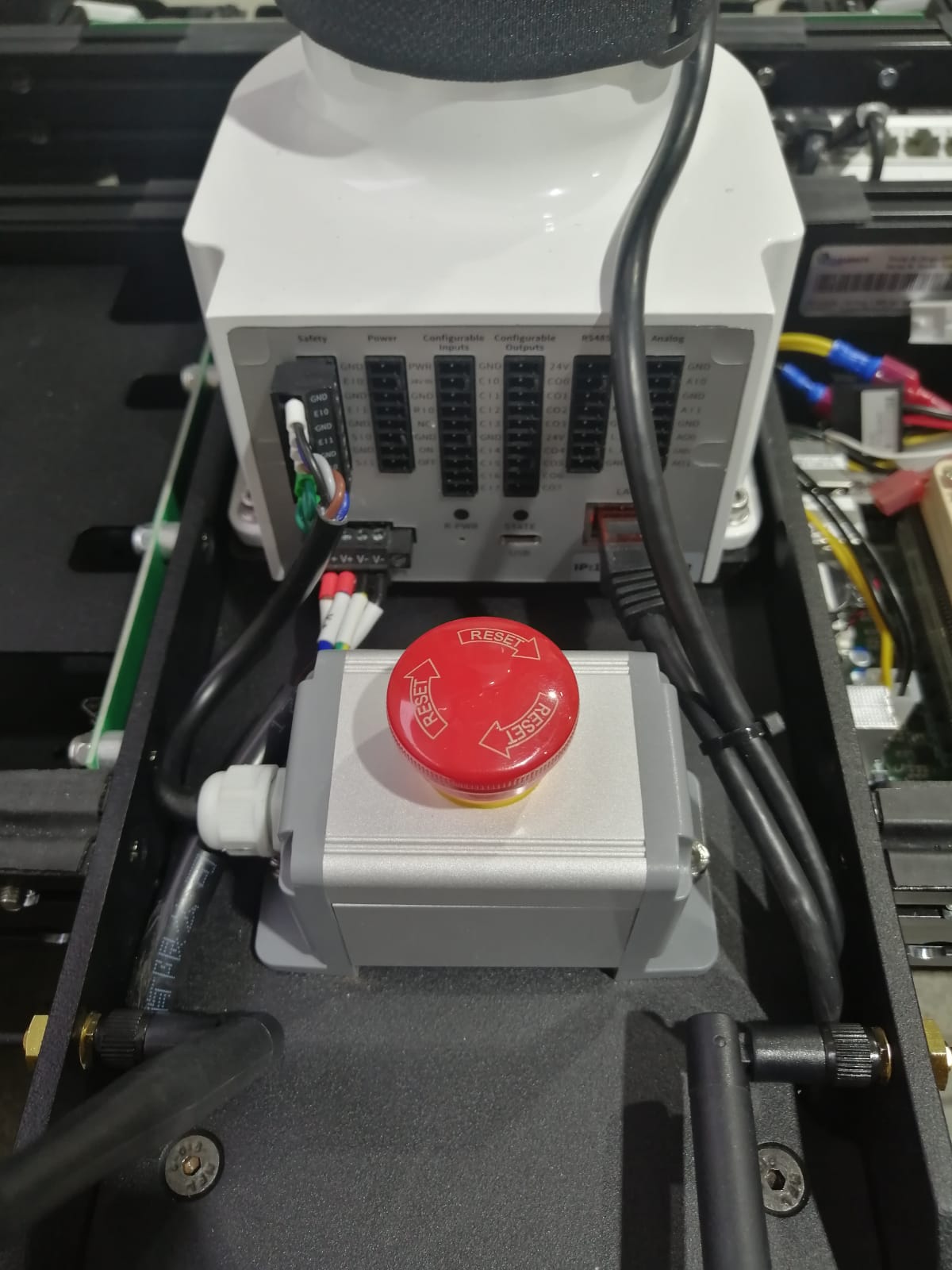

Lite6 E-Stop
_images/e-stop.webp
There’s a red Emergency Stop button positioned at the rear of the mounted Xarm. Pressing this button cuts off the power supply to the arm, providing a manual method to halt the arm in case of any malfunction or emergency situation.
