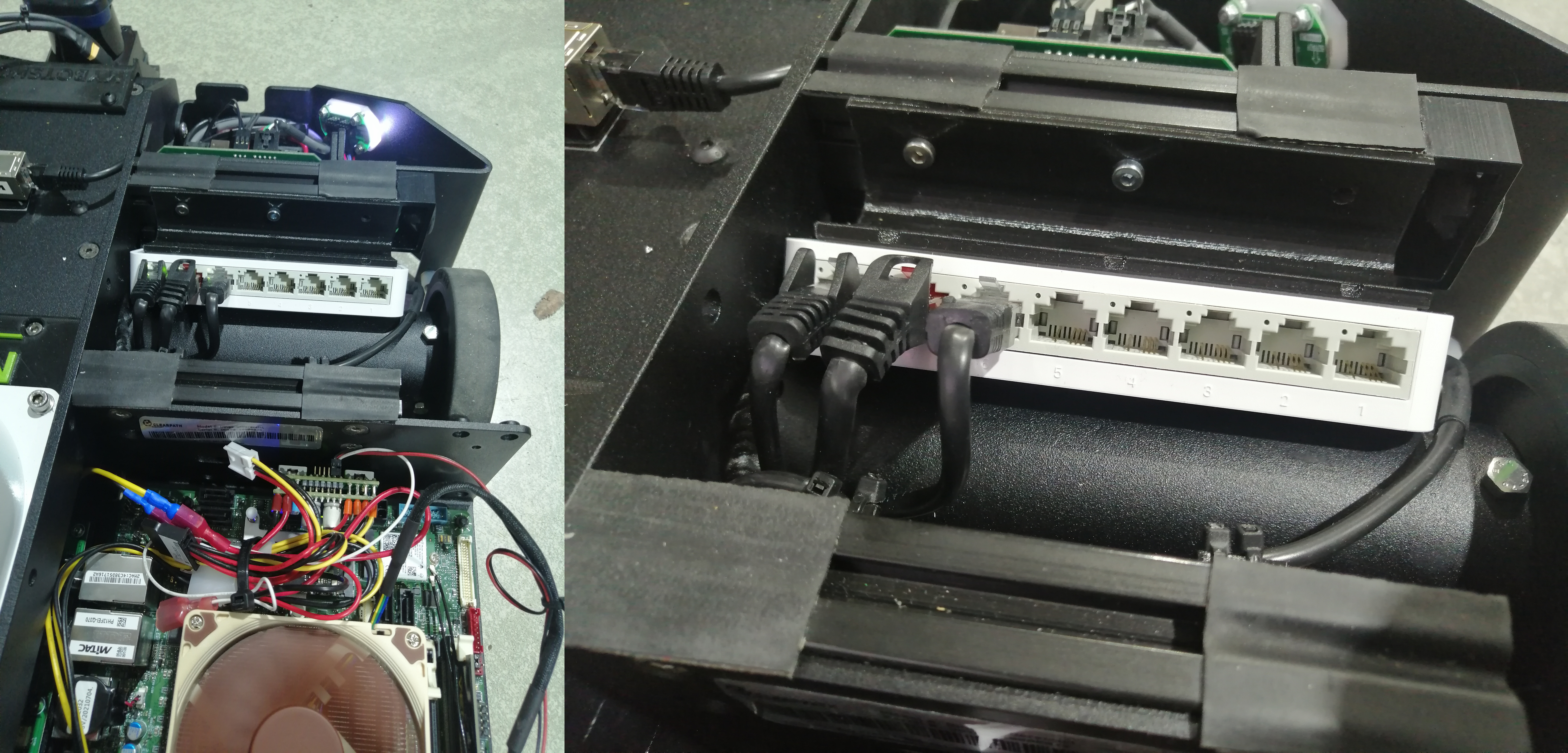

Ethernet Connection
If you aim to establish a direct Ethernet connection to the robot and execute commands directly on the robot, you can connect your PC’s Ethernet cable to one of the available ports on the onboard switch.
_images/switch.webp
Important
Please be aware that the primary onboard PC communicates with all sensors (MCU, Xarm, Hokuyo) and their drivers through the switch. Avoid unplugging any Ethernet cables, as doing so could potentially disrupt the robot’s functionality.
