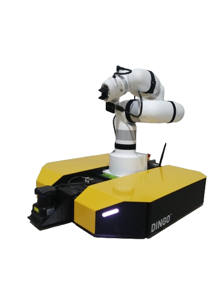

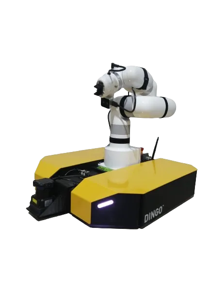

Dingo-D
_images/all.webp
To operate the robot remotely via PC, you need to setup your network as described in the Dingo-D Network section.
Please note that the command mentioned above is for explanatory purposes only. You need not manually execute this command, as the dingo hardware drivers are automatically launched during the robot’s startup process.

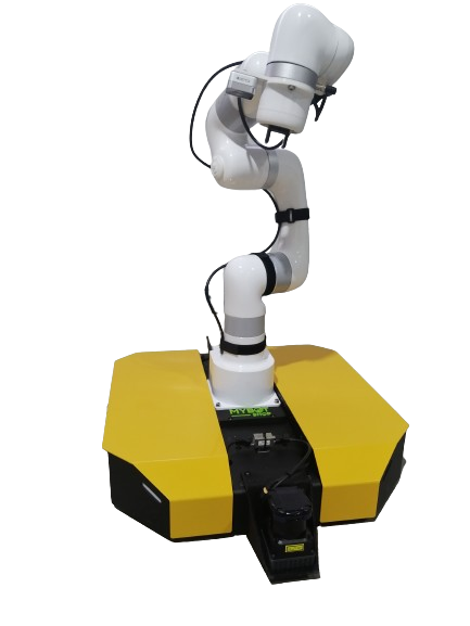

Ufactory Lite6
To start the hardware-lite6 drivers, please launch:
roslaunch mmp_bringup lite6_driver.launch
This driver does not launch on startup. It is required for controlling the Lite6 arm.

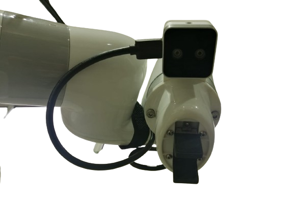

Realsense D405
_images/cam.webp
To initiate the hardware driver for the Realsense camera mounted on the wrist of the Xarm6 Lite, execute the following command.
roslaunch mmp_realsense wrist_camera.launch
If the camera drivers operate correctly, you should be able to view the camera stream on RViz by following the instructions outlined in the “Visualize” section below.

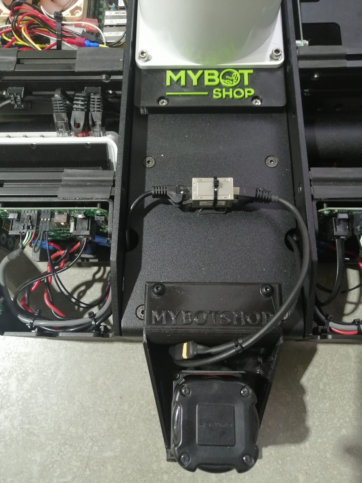

Hokuyo Lidar
_images/hokuyo.webp
You can start up the Hokuyo driver located at the robot’s front by employing the command specified below.
roslaunch mmp_lidars lidars.launch
Once running, you should be able to view the laser scan data created by Hokuyo on RViz by following the instructions outlined in the Visualize section below.
