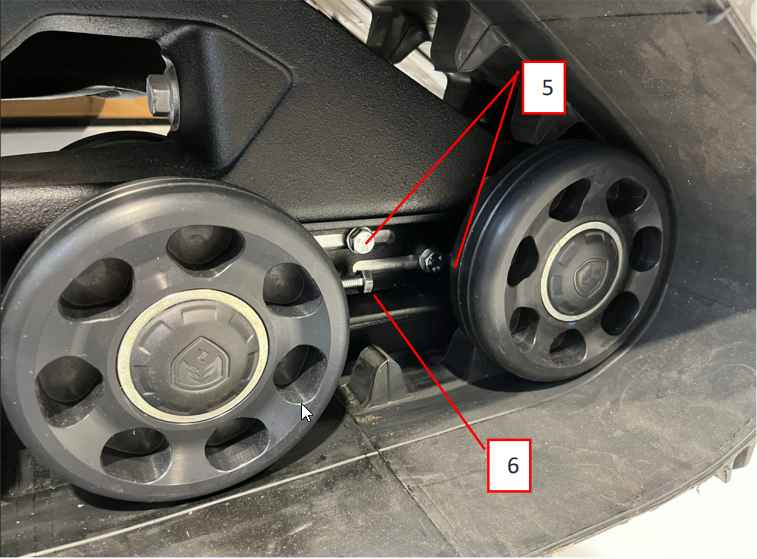

In case the ROVO veers off to either the left or right, the issue may be traced back to the tracks being loose.
To remedy this situation:
First you have to loosen the screw number 5.
Then you can adjust the track tension with screw number 6.
Finally, tighten the screw number 5 again with
25Nm
