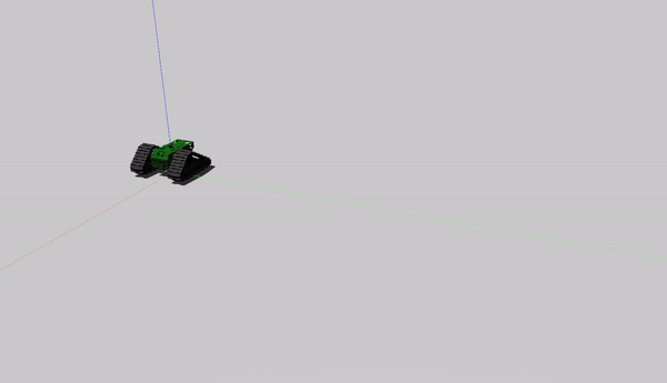

Rovo Description
This is a ros package that contains the 3D models of the Rovo. Additionally, the seperate 3D models are stitched together into a single
entity via the universal robot description format (URDF). It contains the models for auxiliary components such as lidars as well. Additions
to the robot’s 3D model can be made in the xacro/rovo.urdf.xacro
. To view the robot with simulated dummy drivers. You catkin
run:
Warning
Running this command will shut the Rovo Bringup
dscription driver. You may to need to restart that if you wish to view the
running robots state. It is ideal to run this on your own PC when the robot is not attached just to adjust the position of your
auxiliary components.
ROS-NOETIC
roslaunch rovo_description description.launch
ROS-FOXY
ros2 launch rovo_description description.launch.py
