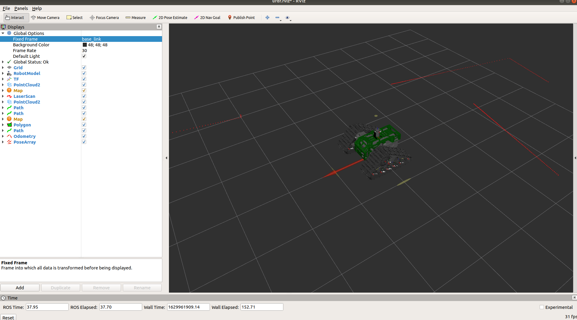

- Once the ROS packages are set up for use, you can verify whether they are working correctly or not by running the following command; be sure to change the - Fixed Framein the global options to- base_link:- roslaunch rovo_simulator gazebo_world.launch
- This should start two applications, the first is Rviz, and the second is Gazebo with pre-loaded gazebo drivers.
- The Rovo should be visible, also double-check the frame is correctly selected to be the - base_link.
