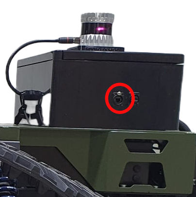

1. Connect an Ethernet cable from your Host PC to the Ethernet port of the Rovo (or connect with WiFi if
available password:mybotshop).
Rovo ethernet connection port.
